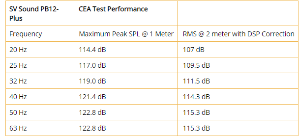

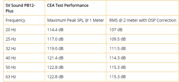

So I did some more research and it looks like the SVS -PB12 plus is good to compare with the vtf-3 mk5 HP.
Here is the measurement for the PB12-Plus

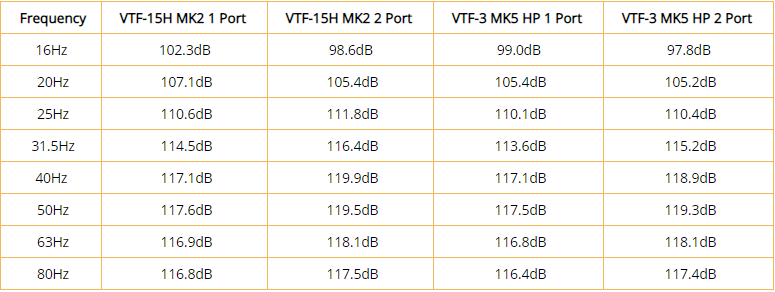

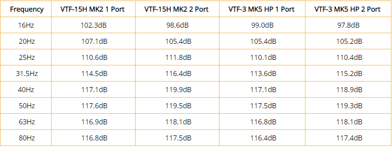

And the HSU at 2 meters

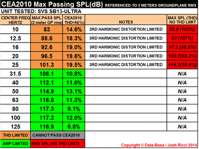

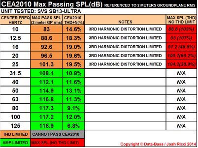

And of course here the SVS -13 Ultra measurements

Looks like the HSU dropped by 11.7 db from 40hz to 20hz where as the pb12 Ultra dropped only by 7.3db
My SB-13 Ultra dropped by 10.8. If I understood this correctly then the PB12 will have heavier bass then the HSU
The HSU will have 2 to 3 more db around 40hz and above. Of course my SB-13 Ultra will catch up aournd 63hz
