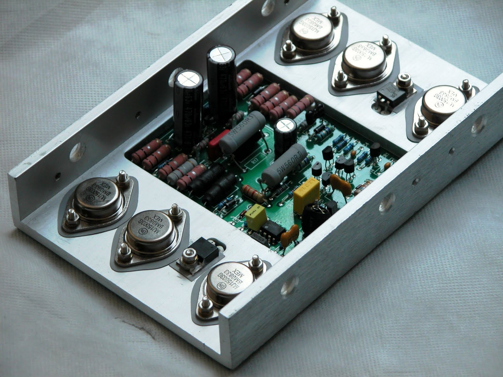

Let me start by saying it is my right to guess that Mr. Pass could not tell it apart from his other SS amps using the first watt in a DBT.:D:D Another thing, +ve feedback? Wow, I wouldn't want to spend 3K experimenting. Still, for 3K it seems like an affordable toy for die hard audiophiles.
Well, my power amps are all +ve feedback. Peter Walker did not call it that as he was afraid of just your reaction. Instead he called it feed forward! But it is +ve feedback, but actually feed forward is a more descriptive and accurate term for it.
I have always thought that Nelson Pass has used a lot of Peter Walker's ideas in his designs.
The thing is that Peter Walkers amps are much simpler than all the circuitry designed to overcome the problems of class A/B. The amp boards are small with a low component count.
Here is a Quad 909 amp board, 250 watts into 4 ohms class A and it makes very little heat as the power transistors are biased heavily to B, and the class A amp feeds forward to correct the dumpers and sets the class A spec.
Elegance in design! It does not cost 3K either.
I happen to know feed forward quite well and I am not sure that's what Mr. Pass was talking about. Why would he call it feed forward then? Anyway, I guess you could be right.
Regarding those Quad amps that you like so much, they didn't have the best bench test results in the Miller Audio research Avtech lab. Regardless, you've got me very curious about them, almost enough to want to try one if I can find one at reasonable cost.

The trouble with bench testing is that it tests under resistive load conditions. A speaker is anything but. This always bothered Peter and he was always at pains to really try and make his amps performance independent of load as far as possible.
Now I will concede one thing. I have used these current dumpers most of my life now. So my speakers were designed and voiced using those amps. So it is certainly possible my designs are optimal with those amps.
I have long thought that ideally amp and speaker should be designed as a single entity.
"Now I will concede one thing. I have used these current dumpers most of my life now. So my speakers were designed and voiced using those amps. So it is certainly possible my designs are optimal with those amps." He probably voiced the amps as well to obtain what he wanted . BTW ......I think it is a bit unfair and irresponsible to call Nelson Pass a plagiarist , especially without proof . He has many patents and gives his schematics , time and experience to the DIY community . Not only that , to most audiophiles , his work is the pinnacle of solid state design , build and sound quality .
