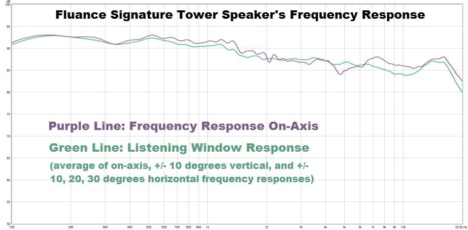

Can you guys believe that James has kept us from the full truth about these speakers. Left us blind to their vertical polar response because he didn’t want to rig up a complex counterweighted rig to allow him to measure a 70lb tower 10 feet above the ground at 5 degree increments about the tweeter axis. Come on, how hard could it possibly be.
They do measure impressively well and come in at a reasonable price.
I still think you should have gotten the vertical polars @shadyJ , ya’ bum!
If I did vertical polars on a tower speaker, I would be the first reviewer in history to do that, as far as I know. It might be worth a try just for bragging rights, even if the data that would provide would hardly be crucial information as to how the speaker would sound. I would probably end up destroying a bunch of towers just to get it to work once.
As reviewers it is not our job to be merely status quo. We might rise above the normal to provide answers to the questions our readers seek. They seek verticals!
For what it’s worth, both stereophile and soundstage do verticals on towers. Atkinson only doesn’t give those if the tower is really huge.
Of course SS has access to an anechoic chamber, which we do not, and Atkinson uses a different measurement technique.
I think you know I’m just harassing you.
To be sure, I have published vertically-oriented measurements on towers before, like here and here, and I have performed a lot more unpublished vertically oriented measurements on towers, but I have found that the response doesn't change all that much outside of an angle that matters. So if you are listening in a 15 degree angle of the intended listening height, which almost everyone who uses tower speakers would be, there will not be enough deviation to worry about. As you know, it's the horizontal dispersion that will make a far greater difference.
