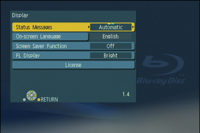

Was there a way to check what firmware is on the player? I downloaded and burned to disc and it said Unsupport, which the instructions said means the firmware is the same.
Hi, John. Yes, there is. I don't have the manual handy, but the firmware website states this as the first step in the process:
Panasonic Firmware Download Site said:
Step 1. Check the firmware version currently installed in your BD player
Follow the steps below to check the firmware version currently installed in your Panasonic BD player.
Steps
1. Turn on the main unit.
2. Press the [SETUP] button on the remote control to open the display menu screen.
3. Using the Up and Down cursor buttons on the remote control, select the "DISPLAY" tab - "DISPLAY" items will appear.
4. Press and hold the [STATUS] button on the remote control. While doing so, the current firmware version for your player will be displayed in the lower right hand corner of the screen (e.g. "1.4").
Please make note of this version number.

Mine did the same thing when I tried to feed it the burned decompression program or whatever that second thing was that downloaded with the FW update. Am I the only guy this happened to?
Anyway Adam has the answer which is the same thing jostenmeat pointed me toward. It told me that my FW was version 2.0 ... 2.2 is the currently used one. So ... now that I have a functioning burned disc, I would just love to be of some small assistance by sending it to anybody ... postage paid.
