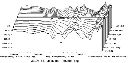

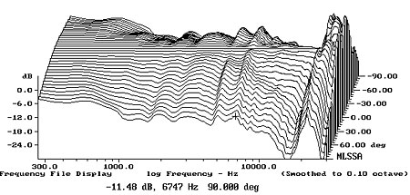

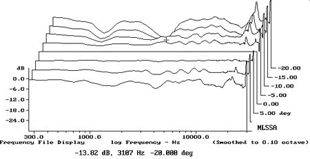

None. They seem to share the same woofer and tweeter, but, there is no mid on the two way 162. So they attempt to match the directional characteristics of a small piston (3/4" dome) to a larger piston (6.5" woofer), without the benefit of an in between diameter driver (4" mid in the 362). You can see the result, horizontally and vertically:
162
360/362
There is also less smoothness in the direct on axis, due most likely to different diffraction signatures of the baffles/driver arrangement and XO filter (not sure about the rise above 10k).
