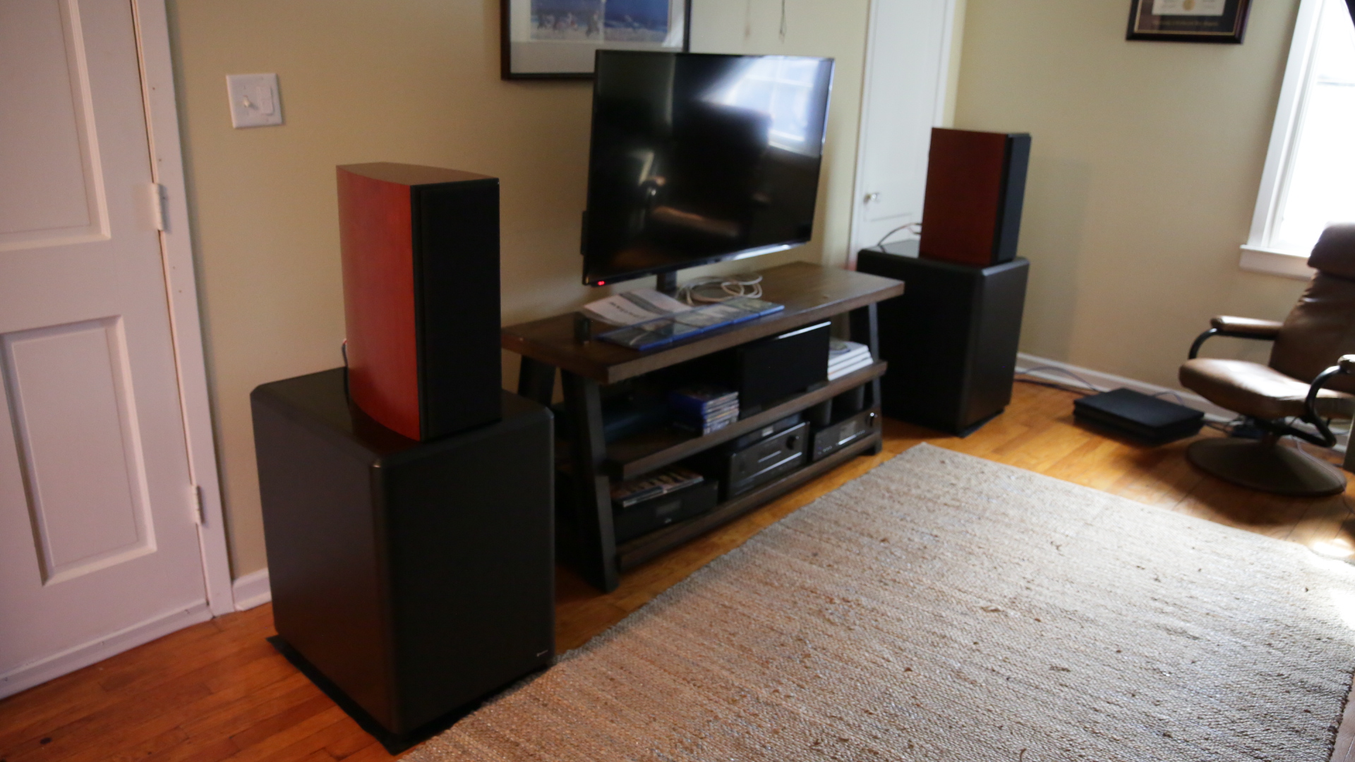

When I set up, I re-ran ARC and played around with bass management. This is what I ultimately ended up at:

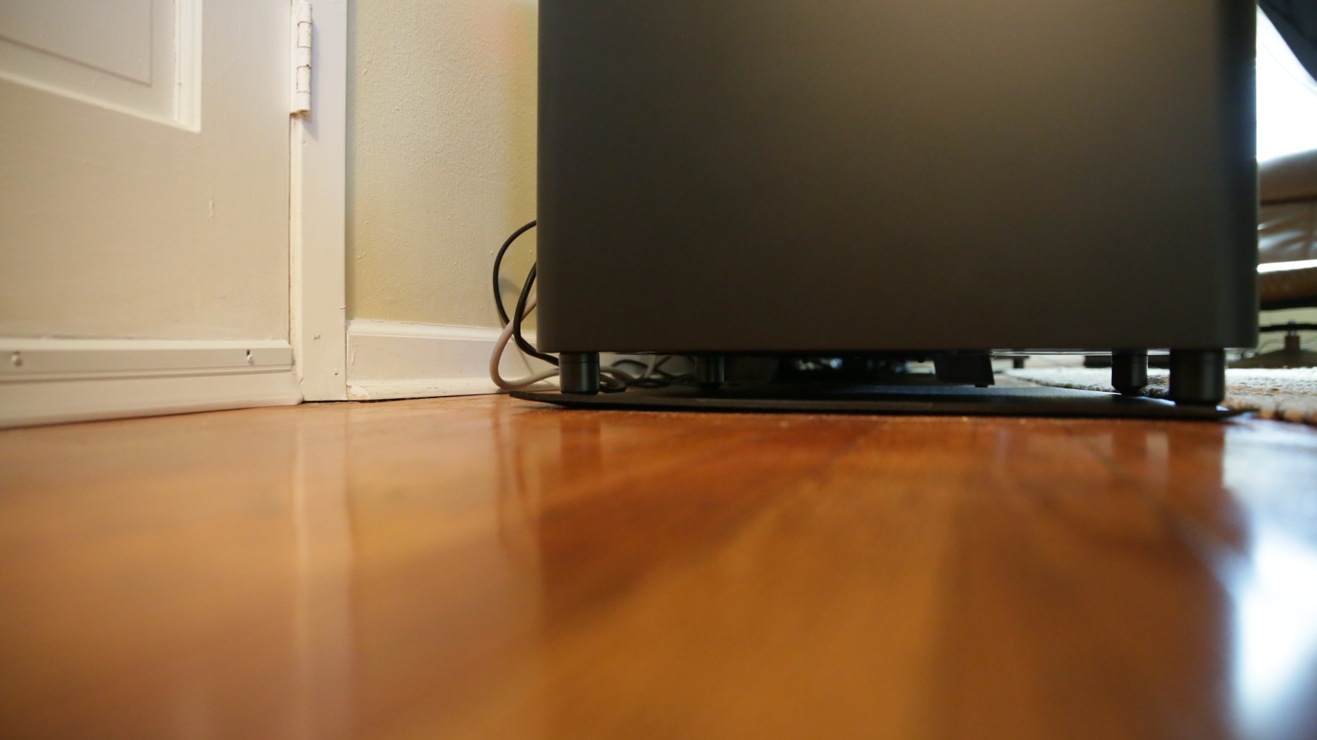

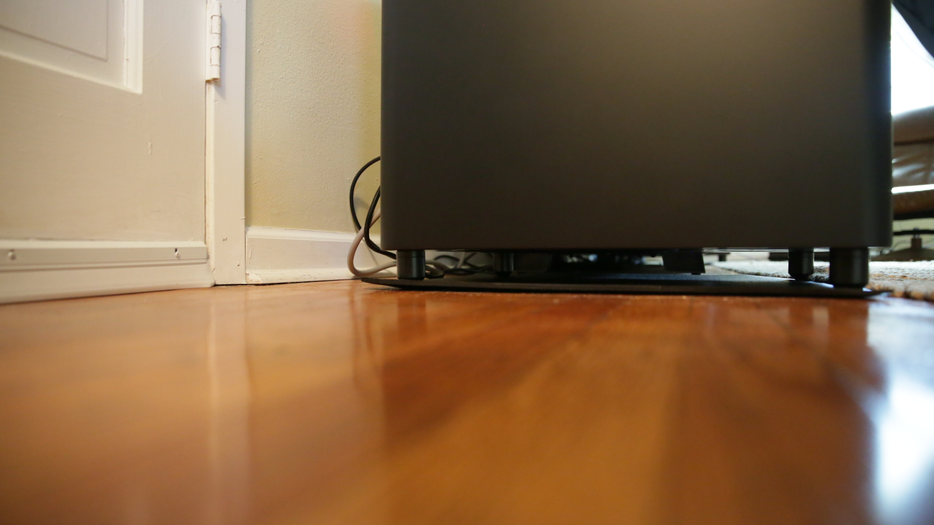

Put a rubber matter under so I could slide it around a bit easier:
Thought the rubber might be messing with the bass. Sure enough, it was, when I removed it I could immediately tell an improvement in SQ.
These subs do very well with deep bass. I felt like I was at a movie theater. No joke. I was running them in EQ 1 mode with 1 port open and then EQ 2 mode 2 ports open (This is the THX ultra mode). I could not hear a lot of difference between one port open and two ports open when watching movies. It seemed like the THX mode may produce a little more bass but not enough for me to be able to tell a big difference. Here are some of the movies I went through that have fun bass content:
I was watching the Dark Knight. There is the scene where the Joker blows up Gotham hospital towards the end of the movie. So when the second hospital explosion right before the Joker hopped on the bus, my empty bottle of water rattled off the table. Craned both subs up to max when watching live, die, repeat, intro. WHoooooo. They handled it fine. Rewatched, some of these scenes in EQ 2 mode with both ports sealed I think I've found the sweet spot. Really like this configuration and it's what I think I'm gonna stick with for a while. Powerful deep bass that hits hard and doesn't distort in the least.
Tweaks/ Acoustic Problems: I now truly understand why people spend a lot of money on bass traps. When watching the U-571 I could totally tell the bass getting overloaded in the right corner of the room and sounded bad. (You guys don't have to tell me my room is an acoustic nightmare, I know) I was able to tell the that bass on the right was running hotter than on the left. (So due to the fact that this room isn't a perfect rectangle, there is a little kitchen area behind where I'm taking the pics.) A lot of the bass gets thrown back there from the left sub. And since the right sub is right by the corner it naturally has a lot more gain. Getting a balance was a bit tricky. So the sub on the right I turned down by ~-8 dB. I could still hear the bass being more localized on the right...a long time goes by............ Ultimately landed here: -18dB on the right + phase 180 | +1dB on the left + phase 0 . Two things got me thinking here since there is such a big difference in gain. #1 Bad sub placement. #2. May get an RCA splitter and get the HSU back in the mix and try running 3 subs. Next weekend I might try pulling the left X-13 so it's directly to the left of my listing position.
Music: my favorite specs for the subs for music are EQ1 mode with both ports sealed. Listened to jazz, classical, rock, rap, etc.. I think rap/ hip hop/ electronic sounds best on these subwoofers. Since these things are so big I found that the soundstage of the music improved a good bit. Since the speakers are now about 1/2 ft + further off the wall. I have no problem with tweeter hight. It's about ~1 foot above my ear whereas on the Sanus 22" stands the RAALs were ear level.

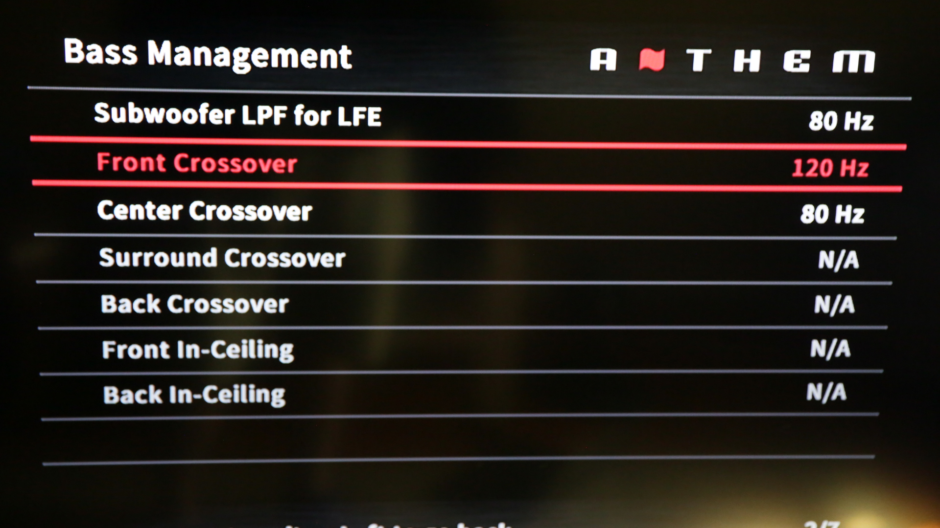

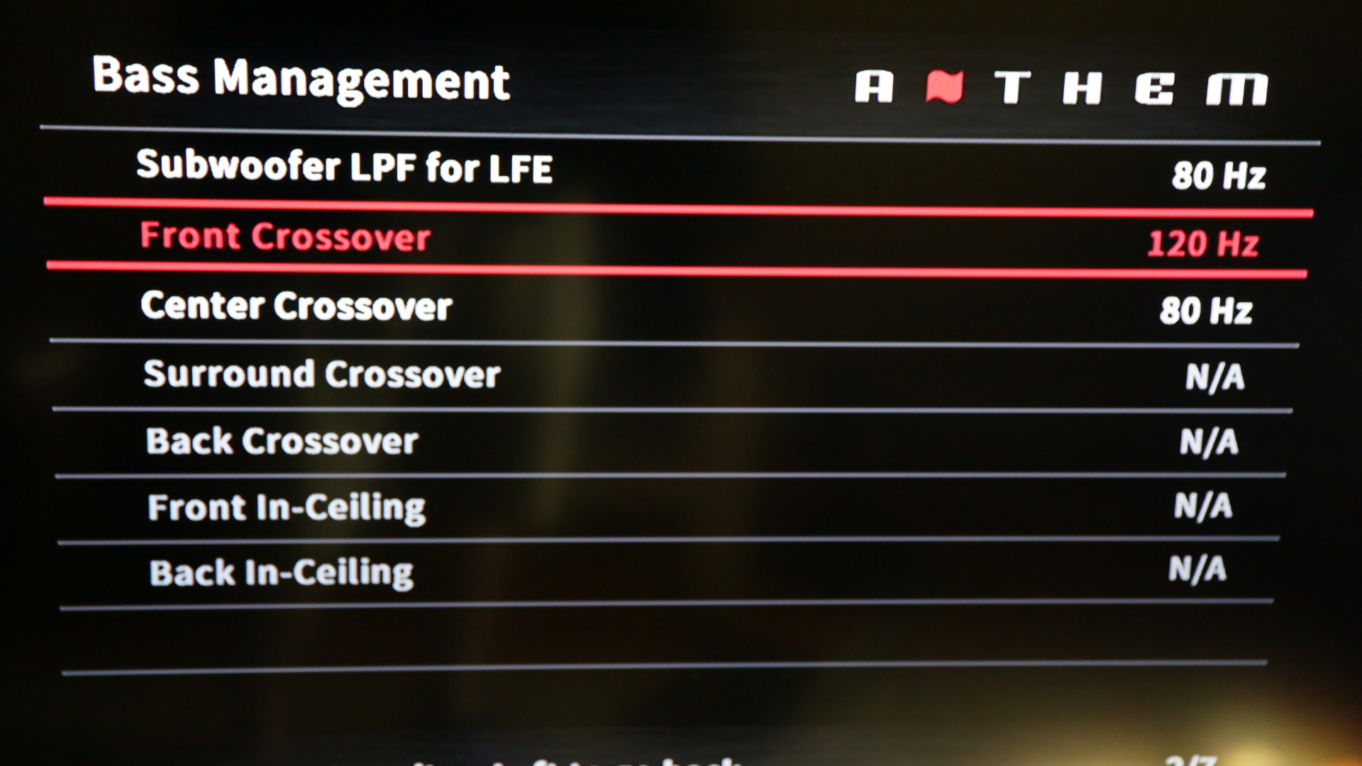

Hey I also noticed that the LPF of your LFE on your screen saver for settings was set to 80hz. I thought that was supposed to be set to 120hz? Its a long shot but that might be an issue as well
