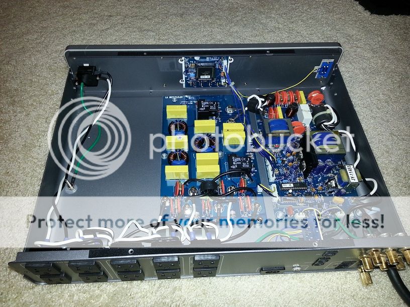

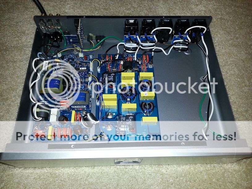

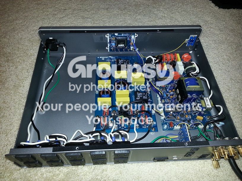

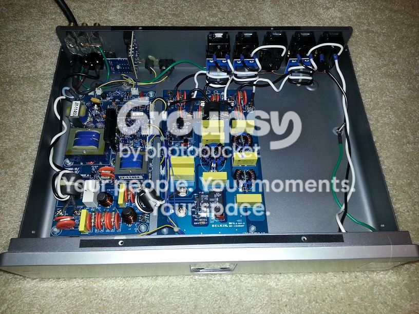

Measuring the DC offset takes an oscilloscope. Good catch on that Emotiva product! I never noticed it. Yes, that looks like exactly the device to solve the problem, if indeed my guess is correct. The price is right, and it's rated for 15amps of current, enough for most amps, though not the ATI AT3005, obviously.
RichB
RichB
It says 15 amps but the plugs are for 20 amps. Maybe they were just hanging around.
How would such a product work?
I am curous because I am skeptical of such product claims.
- Rich
Adam
Adam
The guts of that Emotiva product look a lot like the Belkin and Acoustic Research power conditioners that I've taken apart. I can't recall if they claim to eliminate DC offset, though.
Emotiva
Belkin
Irvrobinson
