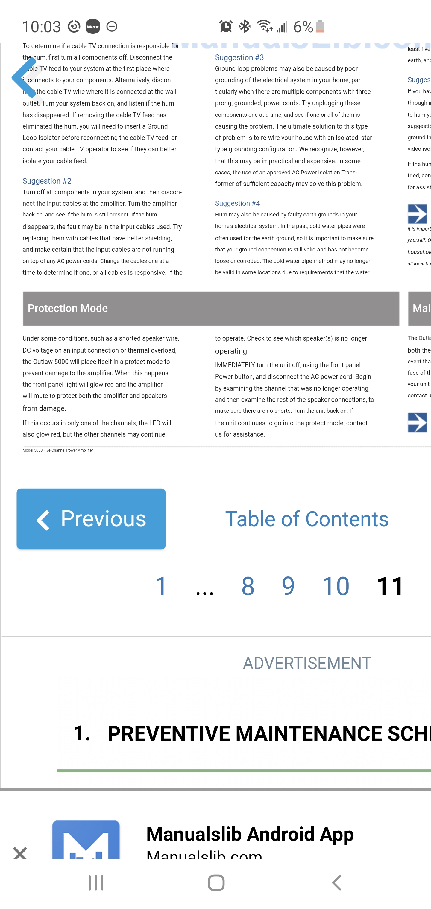

Any ideas or suggestions as to why it might be going into protection mode? The only thing I could find in the online manual was this:
I don't think it's a voltage problem, or thermal overload considering the amp was on for a total of maybe 5 minutes. So that leaves a shorted speaker wire? How would I be able to check/tell if that is the case?
