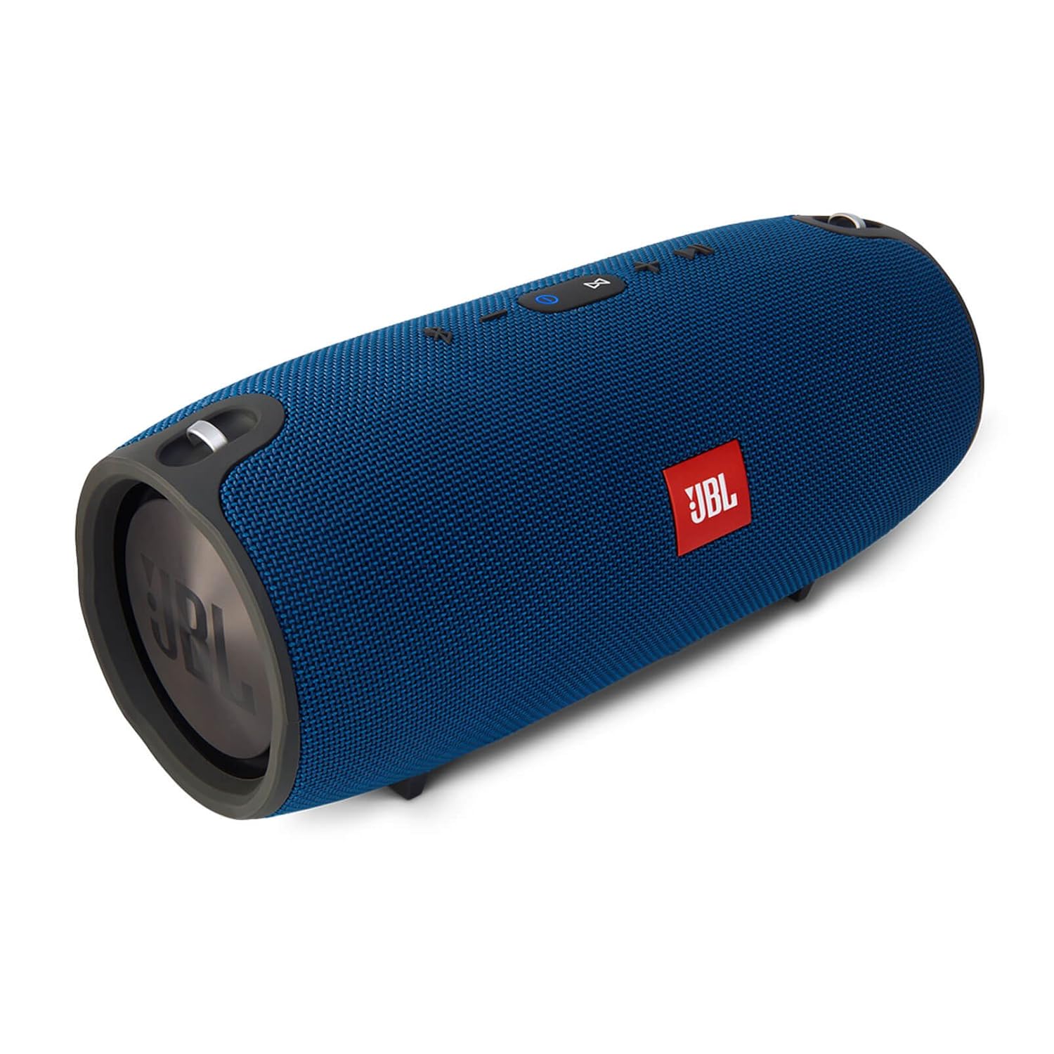

Or just get a blue tooth and plop it on table ?
I was just thinking the same thing. I gave my GF a JBL Xtreme for use with her pool and she is getting more goody out of it than I could have ever anticipated! It does a fine job of blanketing her pool with great sound! It followers her whenever she does yard work. It is also splash proof - you can rinse it, but not submerge it. It goes with us to AirBnB's and provides a high capacity USB-ported power bank, just in case!
With the reinforcement indoors, it is bass heavy (though most BT sources have EQ options via apps so you can "fix" that); however, outdoors, it packs nice bass. The passive radiators are cool to watch with easily 3/8" travel (and we haven't played it so loud as it will go... yet).
Anyone who has heard a JBL Flip was probably impressed with the output...this is a Flip on steroids - Using the external dimensions, the Flip is 40 cu. in. and the Xtreme is 590 cu. in.! Specifically, the Flip is 2.7" dia by 6.9" long and the Xtreme is 7.75" dia by 12.5" long.
I think true outdoor speakers would sound better, but there is something to be said for being able to move the speaker to where you need it!
Whether it is right for you largely depends on how valuable the portability of something like the Xtreme is to you, but it does add a lot of possibilities. At just under 5 lbs and too large a diameter for smaller hands, it comes with a shoulder strap!
Also, you can couple two of these together should you want. I'm not sure if it is stereo or dual mono.
