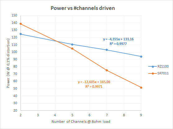

Interestingly the RZ1100 can drive seven channels continuously into 8-ohm loads with 0.1% distortion at 103.2 watts and 1% distortion at 126.5 watts.
The Marantz SR7011 can drive seven channels continuously into 8-ohm loads with 0.1% distortion at 75.1 watts and 1% distortion at 90.4 watts.
If one performs the analysis of the power delivery to 2/5/7 channels for each AVR one can assume the SR7011 will have issues handling 9 channels continuously on higher power consumptions (see image below).
Buy using a simple linear regression for both AVR's (although the SR seems more like a polynomial then linear, this is only to prove a point!) class D of the RZ can "easily" handle the higher demand of channels when compared to the AB amps of the SR counterpart. RZ1100 could handle 9 channels @ near 90W/channel with 0.1% distortion while the SR7011 can "only" handle near 50W/channel with 0.1% distortion.
It is my opinion that these new Monster AVR's with 11/13 channels must be tested in their full capacity. After all, people that buy these AVR's intend to use them in their full capacity either immediately or in a not so distant future upgrade.
It is my belief that class D amplification is the way of the future when we start talking about Receivers with 9/11/13/(and above!) channels. In both terms of power delivery (power efficiency) and thermal management of the receivers internals.
Obviously class D makes sense for the much better efficiency but between the two I would take the Marantz for the better distortion figures and the better 2 channel driven into 4 ohms performance. You are right about the marginally better 5/7 channel driven output figures but those have low to zero practically value for real world applications.
