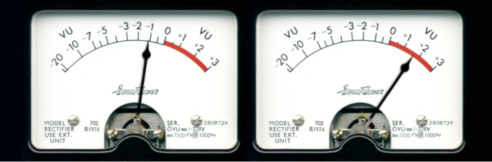

That sent me down a rabbit hole! Long story short, I now have analog vu meters for foobar! Lol
Mine displays the meters in the lower left corner tho. I'm still tryna figure out how to move underneath the queue like the image...
