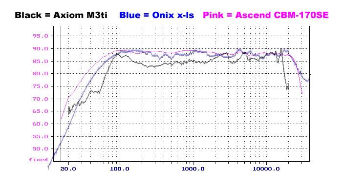

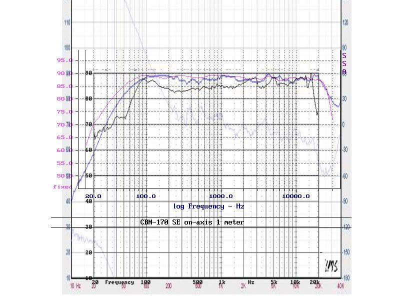

I'm hesitant to post this as likely I'm going to have someone telling me why its wrong to do this, but I think it might spur some good discussion. If nothing else I'll learn.
I took the SPL vs freq plots of my three main contenders and overlaid them for comparison in Photoshop.
Onix x-ls ($200/pair) - FR plot taken from the audioholics review.
Ascend Acoustics CBM-170SE ($350/pair) - taken from their website.
Axiom M3ti ($320/pair) - taken from their website.
First of all, just to show that all was fair and square, here's the original overlay before I began to clean it all up - this shows that the frequencies and SPL scales line up for each. But its hard to read.
Then I took and cleaned up everything but a single scale and the actual traces. Here's what pops out:
Observations / conclusions:
  • It appears that Ascend is not using the same resolution in the sweep as the AV123 Onix and Axioms are. Just a point of observation that while it appears smoother this is likely due to test equipment setup and not actual performance.
  • The Onix x-ls appears to keep up with the CBM-170s in all areas but low frequency extension, where the 170s seem to go about 10-15 Hz lower (eyeballing it)
  • I think this pretty clearly shows why some folks describe the Axiom M3s as being "brighter" than the 170s. There is a roughly 3dB lift in frequencies above 2kHz compared to those below 2kHz.
  • It seems to me that the x-ls and 170s would, from these charts, sound more "neutral" than the M3s. Thats not to say that some folks wouldn't prefer one sound over another.
Guys, I'm a EE, not an acoustical engineer. So go ahead, fire away at what I've done here. I've got a thick skin.
(EDIT: I know this is not the only way to measure speaker performance, but its the only data I could find for all three.)

Wilkenboy - Pretty cool stuff with the graphs. You are possibly right that the 170 SE's are "smoothed" ... It is pretty difficult to do a direct comparison of different measurement sessions done with different equipment. The Ascend graph LOOKS like a Melissa 1/3rd octave, but they don't specify, so it could be higher resolution.
It will be fun comparing all three speakers - We may just have to do a blind test comparison between the three speakers, using a listening panel, open to the public style of test.
silversurfer
From an email to DaveF, I asked, it is MLSSA, but 1/12 octave. I think it is also stated on thier forum.
The NRC measurements(the Axiom graph) are not gated and in 5hz slices or better. Their is an NRC measurement of the "classic" CBM-170 as well.
Craig is right though, comparing measurements done with different equipment and rooms is not a good comparison. That said, I am a big fan of the Soundstage reviews and the measurements they take at the NRC.
