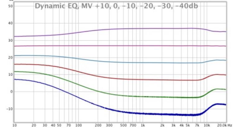

Pogre Audioholic Slumlord Jul 29, 2016 16,146 0 113 56 Mesa, Arizona Nov 20, 2021 #102 William Lemmerhirt said: Exactly. I was trying to articulate but…still shaking cobwebs. Lol Click to expand... Lol. I knew what you meant! It's worth pointing it out too. I should have specified I did those sweeps at 75 dB, well below reference where the effect is relevant. Reactions: William Lemmerhirt

lovinthehd Audioholic Jedi Sep 11, 2012 44,874 0 113 Oakridge, OR Nov 20, 2021 #103 Genchic said: Well, the Audyssey numbers are calculated based on 8 different positions, the SPL is reading from one. I agree with pogre, trust Audyssey. It does a good job in system calibration to a given room. Sent from my SM-N975U using Tapatalk Click to expand... Basic levels/distance is done with position 1, tho. Hetfield said: What are the "offsets" for? Any reason to mess with it or leave it at 0? This sounds amazing right now. Watching "The Bourne supremacy". Whew awesome! Sent from my Pixel 4 XL using Tapatalk Click to expand... There is some of Audyssey's info on DEQ/RLO in this thread, used to be another one that I think was better but can't find at the moment https://audyssey.zendesk.com/hc/en-us/articles/212347383?page=2#comment_203989263 Reactions: Hetfield

H Hetfield Audioholic Samurai Nov 23, 2016 2,781 0 63 50 Nov 20, 2021 #104 lovinthehd said: Basic levels/distance is done with position 1, tho. There is some of Audyssey's info on DEQ/RLO in this thread, used to be another one that I think was better but can't find at the moment https://audyssey.zendesk.com/hc/en-us/articles/212347383?page=2#comment_203989263 Click to expand... Thanks, I'm loving this now that put things back up ever Audyssey set it. Got it on reference and it's sounding great. Sent from my Pixel 4 XL using Tapatalk Reactions: Pogre

G Genchic Audioholic Sep 29, 2021 128 0 16 65 Nov 20, 2021 #105 Turn on Dinamic Volume and set it to Light. See if you like it. Sent from my SM-N975U using Tapatalk Reactions: Hetfield
William Lemmerhirt Audioholic Overlord Jan 8, 2017 12,005 0 113 52 Nov 20, 2021 #106 Hetfield said: Thanks, I'm loving this now that put things back up ever Audyssey set it. Got it on reference and it's sounding great. Sent from my Pixel 4 XL using Tapatalk Click to expand... Fwiw. I never use DEQ or Dynamic Volume. Is DEQ set to on? Reactions: Hetfield

H Hetfield Audioholic Samurai Nov 23, 2016 2,781 0 63 50 Nov 20, 2021 #108 William Lemmerhirt said: Fwiw. I never use DEQ or Dynamic Volume. Is DEQ set to on? Click to expand... On mine yes. I like dynamic EQ. Sent from my Pixel 4 XL using Tapatalk

William Lemmerhirt Audioholic Overlord Jan 8, 2017 12,005 0 113 52 Nov 20, 2021 #109 Hetfield said: Ya know I tried that but didn't stick. That's supposed to be used at lower volumes right? I'll have to try it again at night when I listen at a lower volume to see how I like it. Sent from my Pixel 4 XL using Tapatalk Click to expand... No. Its dynamic range compression. Basically levels all the volume between commercials etc. I can’t stand that shitt. To each his own though. Reactions: Hetfield

H Hetfield Audioholic Samurai Nov 23, 2016 2,781 0 63 50 Nov 20, 2021 #110 William Lemmerhirt said: No. Its dynamic range compression. Basically levels all the volume between commercials etc. I can’t stand that shitt. To each his own though. Click to expand... Yeah I have rarely used it, I think maybe once or twice I first got my X3400H. Sent from my Pixel 4 XL using Tapatalk

G Genchic Audioholic Sep 29, 2021 128 0 16 65 Nov 20, 2021 #111 William Lemmerhirt said: No. Its dynamic range compression. Basically levels all the volume between commercials etc. I can’t stand that shitt. To each his own though. Click to expand... That is Volume Manager, under Surround Parameters. Dinamic Volume widens frequency when Volume is low. Works very well. Sent from my SM-N975U using Tapatalk

H Hetfield Audioholic Samurai Nov 23, 2016 2,781 0 63 50 Nov 20, 2021 #112 Yeah I'm glad I went back to the original Audyssey settings. This sounds really, really good. The 520C sound excellent, dialog is intelligable. It all sounds balanced and quite excellent. Watching "Toy story 3" with the kid right now at -25 which is pretty low and dialog is perfectly intelligable, and clear. Audyssey reference, offset 0. I'm glad I made the move to JBL studio speakers. Sent from my Pixel 4 XL using Tapatalk

William Lemmerhirt Audioholic Overlord Jan 8, 2017 12,005 0 113 52 Nov 20, 2021 #113 Genchic said: That is Volume Manager, under Surround Parameters. Dinamic Volume widens frequency when Volume is low. Works very well. Sent from my SM-N975U using Tapatalk Click to expand... I think you might be confusing that with dynamicEQ. The volume manager under surround parameters enables dynamic range compression adjustments. Dvolume adjusts the dynamic range in the fly so the loud and quiet parts are closer to each other. Makes it so quiet parts are closer to the volume of louder parts. Edit2: widens frequency when volume is low. What exactly does that mean? If you mean boosts low and high Frequencies then yes. That’s dynamicEQ. Looks like this directly from the processor. It doesn’t “widen” anything. It just boosts what’s already there at lower volume. Last edited: Nov 20, 2021

G Genchic Audioholic Sep 29, 2021 128 0 16 65 Nov 20, 2021 #114 That is what I ment, but you worded it better. Bottom line, it improves sound dramatically. Sent from my SM-N975U using Tapatalk

William Lemmerhirt Audioholic Overlord Jan 8, 2017 12,005 0 113 52 Nov 20, 2021 #115 Genchic said: That is what I ment, but you worded it better. Bottom line, it improves sound dramatically. Sent from my SM-N975U using Tapatalk Click to expand... I personally don’t like DEQ, as I use a minidsp to creat my own house curve, and usually listen at fairly high volumes. DEQ also boosts surround levels, AND rear tops. But not front tops. That’s really odd imo. Like I said though, to each his own. Mileage included lol.

Pogre Audioholic Slumlord Jul 29, 2016 16,146 0 113 56 Mesa, Arizona Nov 21, 2021 #117 Genchic said: That is what I ment, but you worded it better. Bottom line, it improves sound dramatically. Sent from my SM-N975U using Tapatalk Click to expand... It levels off and kills the dynamics is what it does. I don't ever use it, but I do like the bass boost from Dynamic EQ. Reactions: William Lemmerhirt and Hetfield

H Hetfield Audioholic Samurai Nov 23, 2016 2,781 0 63 50 Nov 21, 2021 #118 Pogre said: It levels off and kills the dynamics is what it does. I don't ever use it, but I do like the bass boost from Dynamic EQ. Click to expand... Same here, I totally agree. I like what DEQ does but don't use dynamic volume. I live in a townhouse and I'm constantly worried about neighbors. I honestly don't know how I haven't a neighbor come over with a gun. I mean I try like hell to be good, respectful, and a good neighbor. I have never, not once had this HT over -20. That's the loudest I go with it. The subs though, we all know that travels. What really stinks is it's like having a Ferrari but can't go over 50 MPH. [emoji24] Need a house soon! I'm doing some research on acoustic panels and treatments. I've done this before and gave up because it gets too complicated and too expensive and annoying. I'm looking at it a bit. The back wall I'm 100% sure could use some absorbtion. Not a ton, just a bit. Sent from my Pixel 4 XL using Tapatalk Reactions: Pogre
