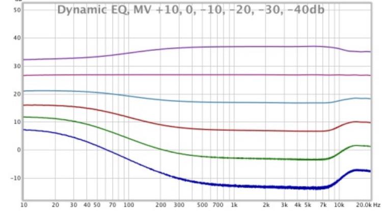

This is what DEQ looks like. When you set the offset to 0, it engages at a much lower MV level. With the offsets, it basically does nothing until you get closer to MV -0.
With any of the RLO’s as you can see. When MV is -0, there is zero DEQ engaged. It’s only to boost lows and highs at volumes BELOW -0.
Pogre
Pogre
Right, and just to simplify, the more you turn the volume up the less boost is applied as you get closer and closer to max reference volume.
William Lemmerhirt
William Lemmerhirt
Exactly.
I was trying to articulate but…still shaking cobwebs. Lol
