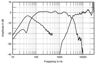

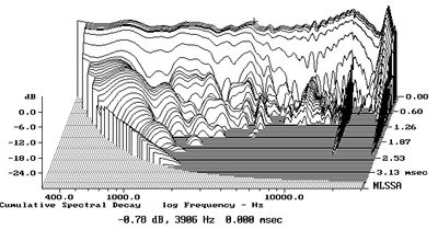

So what? The point isn't about that ... the point is foolishness of recommending a speaker based solely on a spattering of measurements taken by a 3rd party.
Sufficient measurements describe the primary characteristics. The speaker in question, based on the measurements, and presuming B&W did not leave gross non-linear distortion, a very safe assumption, the measurements describe a rather neutral mid-treble module with lower cabinet resonances than normal.
