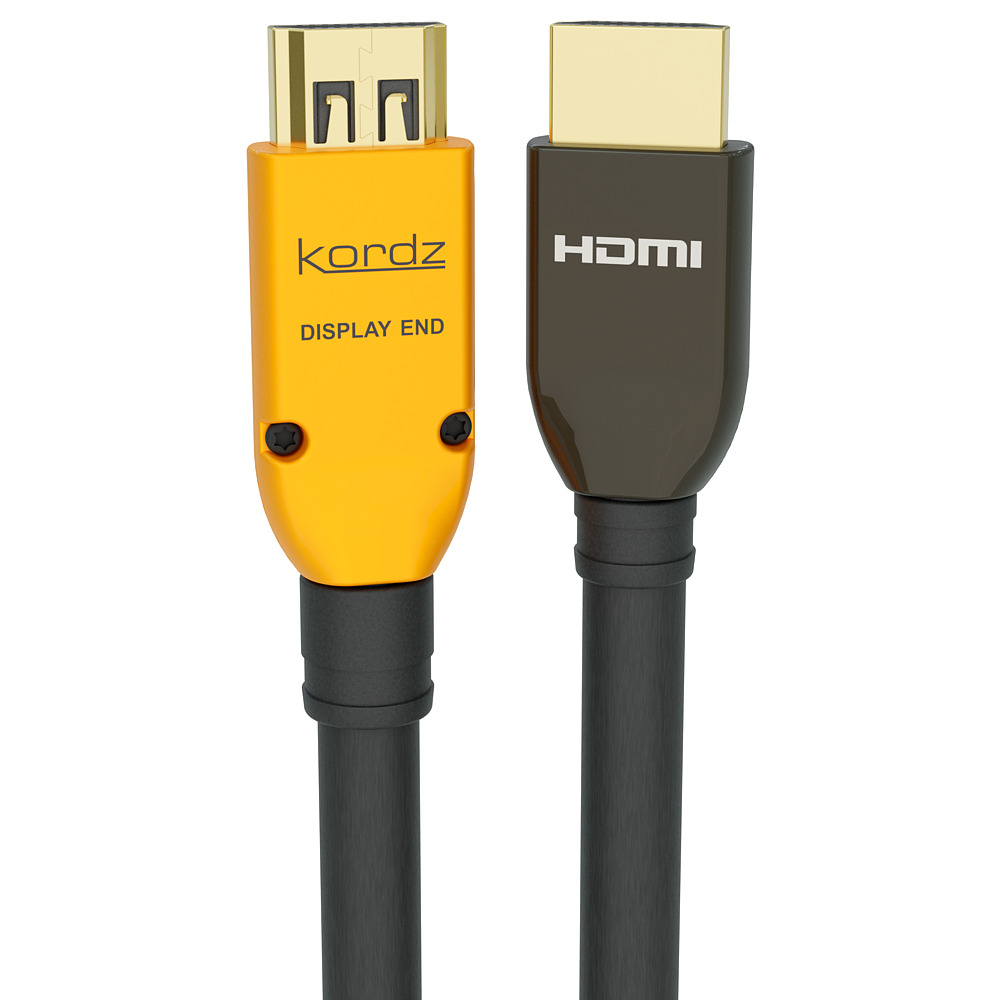

I bought a high end Kordz Prs3 active cable 7.5 mt costing me about 200 dollars, yes that much in India. but no improvement. I even switched off the upscaler but nothing works. My theater is useless now even the suppliers of Epson are scratching their heads,

I'm not sure we can sort this out at such long range. My best guess now is that your Epson projector is out of compliance. Yamaha have their receivers HDCP certified.
It is a pity you did not get an optical HDMI cable. They are better. All the same all powered cables can have problems, as the power draw of all of them draw more power than the HDMI spec. Most of the time it works, but not always. So I would purchase a voltage inserter like the one form Legrand. If that does not cure it, then you have an argument with Epson. I do note you are not alone in the misery. Since 4K came along, I have noted an uptick in these type of postings. I think this is because most manufacturers do not want to pay for HDCP certification, and so are more often out of compliance than they want to admit to.

What makes Kordz cables "hi-end" particularly? Got a link to the spec?
