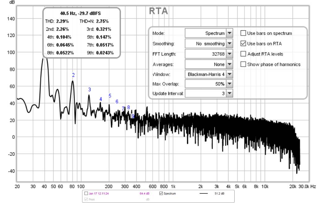

@William Lemmerhirt
I'd agree with you about driver size and impact. Two subs can have the same frequency response and even be able to hit the same spl with low distortion, but for whatever reason, the bigger driver seems to pressurize the room more completely.
As for the RP 160m, they do an excellent job with mid bass, this is the thd at 100dB at 40 hz measured 3m away.

@William Lemmerhirt
I think that this idea would fail in a blind test. Pressure waves do not care about the cone diameter that they were produced by, and consequently your ears would not sense a difference.
As for the difference with the Rythmik sub, what Rythmik sub were you using? One note I would make is that scenes like the Blackhawk Down and Edge of Tomorrow actually reserve a lot of power down to absurdly low frequencies, even below the tuning points of Rythmik's subs. I think a much better case can be made for content which spreads a lot of energy over the deep bass spectrum. For this reason I think that the "pods rising" scene from War of the Worlds continues to be the best scene for demoing deep bass ability of a sub. A significant difference can be felt simply from adjusting any of my variable tuned subs from a 16 Hz tuning to a 25 Hz tuning in mid scene. Probably not much difference would be felt doing that in the Blackhawk down or Edge of Tomorrow opener. Another good one is demoing subs is the wormhole scene in Interstellar. BlackHawk Down and Edge of Tomorrow's opening 10 Hz square wave are not very good subwoofer candy, unless you have a massive sealed sub system or something extremely deeply ported like the JTR Captivator 4000 ULF.
