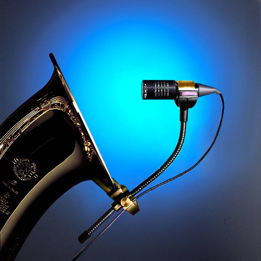

The mic I have is this one:
It's a very good and sensitive mic, but I can imagine that since it's cardioid-unidirectional not omnidirectional that could be problematic. It's made to be clipped on to my saxophone, not sure if it would be helpful testing sound in the middle of a room.
Any thoughts?

Honestly, mic’s aren’t my speciality but I would assume if you had a 90 degree calibration for it, it would work well? I’m honestly not sure, there’s plenty of guys on here with exponentially more knowledge of microphones than myself and I don’t want to steer you in the wrong direction. Bummer about customs! But I totally understand!
Yeah, maybe it's naive of me, but if I just set it up in listening position facing forward the way my face would be.... Wouldn't that work?
I can always try it... REW is free eh? Might as well give it a go.
You do generally want it facing at a 90 degree angle but again don’t quote me on that I’m no expert
