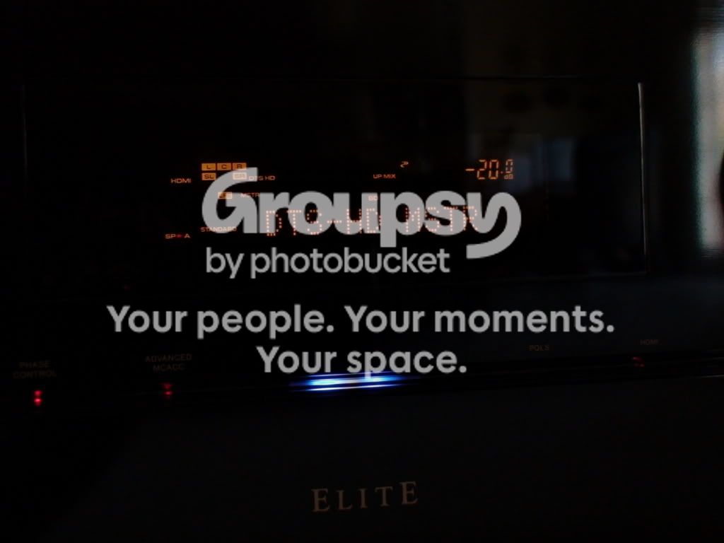

Yeah, but I still want that big a$$ "DTS-HD MASTR" and "DOLBY TrueHD" on my Denon's LCD screen!!!:D
No matter how many times I see those "DTS-HD MASTR" & "DOLBY TrueHD", I still get a grin on my face.:D:D
It's like a daily routine: Wake up --> Brush teeth --> Get dressed --> Go to work --> Go to Wal-Mart --> DTS-HD MASTR & DOLBY TrueHD.:)
