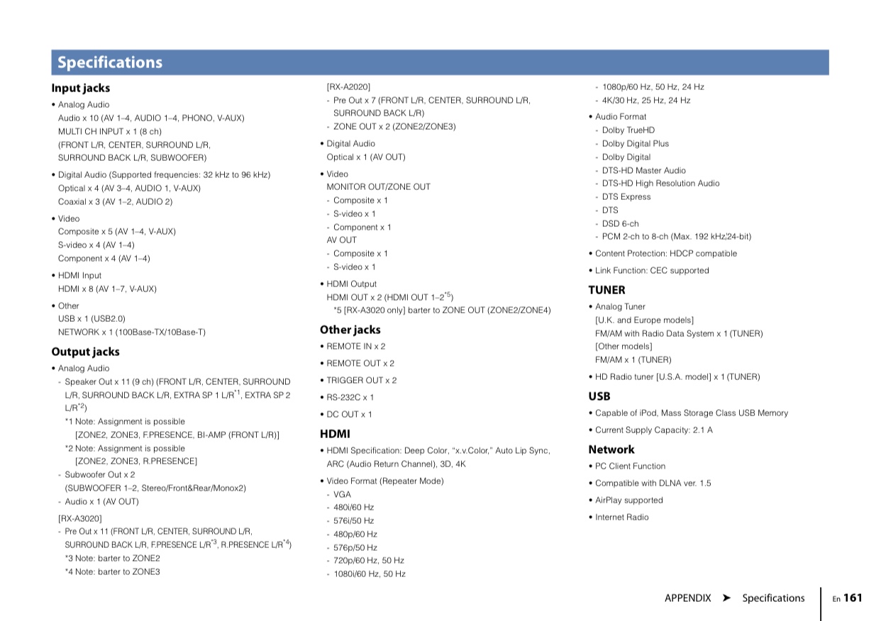

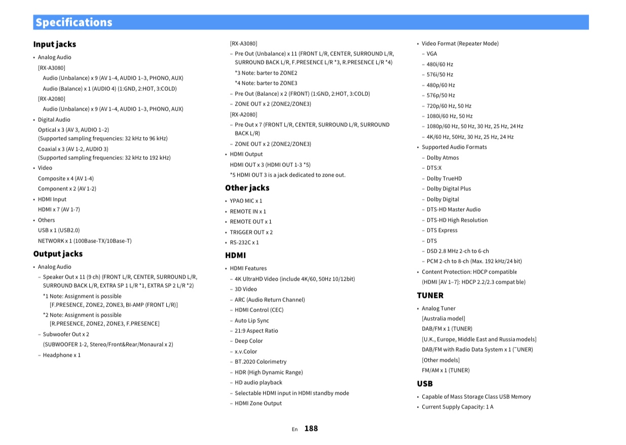

Sorry to hear of the damage to you tv I guess it can happen as was my fear aswell . But all good so far . Hdmi cables all mine are monoprice ultra select certified or what ever I’ve narrowed it down to the 4K pass through on my Yamaha rx-a 3020 it’s an older unit and doesn’t have support for 4K but does allow for it to pass through. Hopeing to use that when I upgrade to a 4K blu-Ray player . I think it’s a handshake issue I just need to pull the system out so I can get to the wires mabey today .
Unfortunately, the 3020 does not support 4K @60hz or HDR. No Dolby atmos or DTS:X on the audio side. If you are keeping it and wanting a 4K blu-ray player, you will want a player with two HDMI outputs to send video to the TV and audio to the Yamaha. You will want the Roku connected directly to the TV as well and use an optical cable for DD 5.1 or ARC for DD+. If you are thinking of an upgrade, Crazy Acu might have a 3080 in a steamer trunk. His prices are iiinnssaannee!!!:D
3020
3080
  • Agree
Reactions: Mark E. Long
3020
3080
Iam thinking of a 3080 as an upgrade for sure as I want everything going through the AVR and yep this older unit doesn’t do well with a pass through of a 4K signal of any kind . It supposedly will by the manual but I’ve got no joy so far . It’s time to upgrade anyhow this has been a decent unit although it was repaired once but I’ve had no problems since . To get the most out of the new display from picture and the audio side it will need to be replaced I’ve herd good things about the new audio side of things I want to try anyhow .

I will try that for sure I’ve got the processor in the Yamaha set to direct no processing when I let the ruko check the connection it goes to 4K 30hz and tells me the hdmi port does not support hdcp2.2 now I don’t have a clue what that means and it resets itself to 1080p which to be honest the new tv upscales to 4K something which is fantastic looking to me lol . I don’t have any idea what that’s telling me when it resets itself. I just want to get the most out of what I have this older Yamaha does a really good job on DD+ from the ruko and the Xfinity HD box too . I will give these sujestions a try and reboot the system and see what goes Thanks for the help !!
You may be stuck and need a direct connection to the TV. That behavior is not uncommon when trying to go through an older unit that does not support HDCP 2.2 but supports HDCP 1.4. You will get much better video from the direct connection and lose nothing from DD+ streams if you use the ARC connection. Here is a bit of info on HDCP.
Thanks that’s a good read . So I need to plug the ruko into one of the ports in the tv and then plug the hdmi into the arc labeled port on the tv and the other end into the arc hdmi on the AVR I think the old Yamaha only has one ARC hdmi input I’ll have to bring up the manual to see for sure on that . Now this new tv has one labeled EARC port too probably another can of worms I’d guess .
