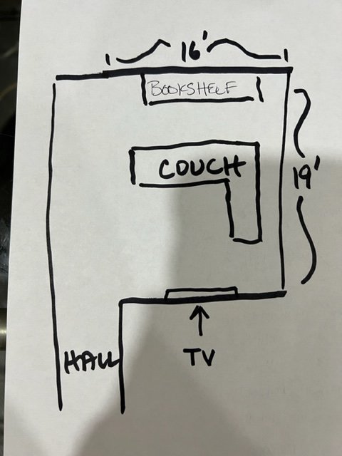

Hi all, I'm brand new to this forum. I've been watching A LOT of YouTube videos over the past 2 weeks, reading articles and trying to learn what I can to set up a room for home theater. To be honest I feel almost more confused and overwhelmed with all of the options and I don't want to make an expensive mistake.
We just did a room addition and I'd like to set up this 16'x19' room with 10' ceilings with a 5.1.2 Atmos system. I prewired the room with 16ga wire in the ceiling for 2 rear surrounds and 2 Atmos speakers and then am planning on 2 bookshelf or floor front speakers and a center and subwoofer. I have a $2,000-3,000 budget to work with for everything. I have an old Velodyne DLS-3500R subwoofer and a Polk CSi3 center speaker but I'm assuming it's too outdated to use.
Can anyone recommend some good AVR/speaker options for me that will work together within my budget? I'm hoping the 16ga wire wasn't a mistake... I could rewire it to thicker wire if needed. Thanks in advance for any advice you can give me and I apologize if this type of advice gets requested too often.

$2-3k is to cover all speakers, sub(s) and avr? Are you looking for in-walls for surrounds? I assume in-ceiling for Atmos? Got a picture/diagram?
The Velodyne is just a small and limited sub, the age isn't particularly an issue....but I'd look at replacing it. I find few youtube videos in the a/v field to be of much use outside of a very few. Don't think the 16ga is going to be an issue, particularly for surrounds/atmos speakers. If you have a 5.1.2 setup, you don't have rear surrounds, just surrounds (more to the side).

Thanks for the welcome! My wife would prefer in-ceiling for the rear surrounds and the atmos speakers but if rear bookshelf would be better I could talk her into that. I was planning on bookshelf/tower speakers for the front surround, but I do have wiring in the wall on either side of the TV if in-wall speakers are better than bookshelf/towers. I would prefer to stay under $3,000 for everything including AVR, but I could push it to $4,000 if it would be that much better. I’m open to something different than 5.1.2, whatever advice I can get is appreciated. Thanks again for the help!

The mistake you made was not having any wires for ear level surrounds.
Atmos has two layers of speakers for a 3d surround sound experience. Think of it like a dome of sound.
Denon is the popular choice here for av receivers.
Welcome to the hobby!
Thanks for the welcome! My wife would prefer in-ceiling for the rear surrounds and the atmos speakers but if rear bookshelf would be better I could talk her into that. I was planning on bookshelf/tower speakers for the front surround, but I do have wiring in the wall on either side of the TV if in-wall speakers are better than bookshelf/towers. I would prefer to stay under $3,000 for everything including AVR, but I could push it to $4,000 if it would be that much better. I’m open to something different than 5.1.2, whatever advice I can get is appreciated. Thanks again for the help!View attachment 61180
Like wardog mentioned, having surrounds (5ch base layer) with the surrounds in the ceiling somewhat negates the effect of Atmos speakers which are intended not to be on the same plane as your surrounds; there should be a separation of layers of bed layer and Atmos layer. They're also not rear surrounds unless you have a 7ch base layer as I mentioned before.

Ah gotcha. Would it work to put the right and left surrounds just behind the seating position on top of the bookshelves? I'm open to putting 4 atmos speaker in the ceiling if that is preferred. Wife doesn't want speakers on the floor except maybe in the front. The bookshelves are about 6.5' high.
Any recommendations on a receiver and speaker setup that could fit my budget? I could push my wife to up to $4,000 maybe but that's a stretch. Thanks!

On top of literal bookshelves or bookshelf speakers?

Just wanted to be sure. What's the height of the bookshelf? That's more positioning of rear surrounds rather than surrounds; surrounds should be more to the sides of seating.

Yes, bookshelf speakers on top of the bookshelves that are behind the couch.
The bookshelves behind the seating area are 6.5' tall

Ear level surrounds or slightly higher. No exceptions or otherwise.
4 feet is the starting point.If it's above your head when standing. It's too high.
Does the wife hate sound?
I'm going to give you an warning here. Your wife is highly likely to negatively impact your surround sound experience. It's been proven time and time again.
Kindly ask her to go somewhere else if she hates sound.
I'll only encourage going for a 9 channel receiver when you're commited to place the speakers properly.
This means 4 atmos speakers at 45-55 degrees elevation from ear level. And surrounds near ear level at 110-120 degrees. Center channel is 0.
Best of luck and hope you understand that placing speakers wherever you or anyone else wants. Isn't the best solution.
