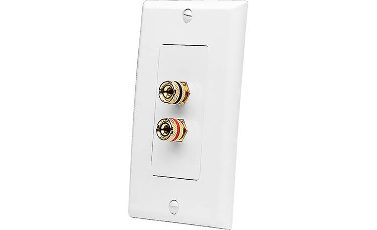

My speakers are higher on the wall than I’d like. I’d like to lower them but my in wall wire isn’t long enough. I currently have a wall plate like you showed me on that picture. But if I move the wall plate down the wall 3 feet from where they are the in wall wire won’t reach.

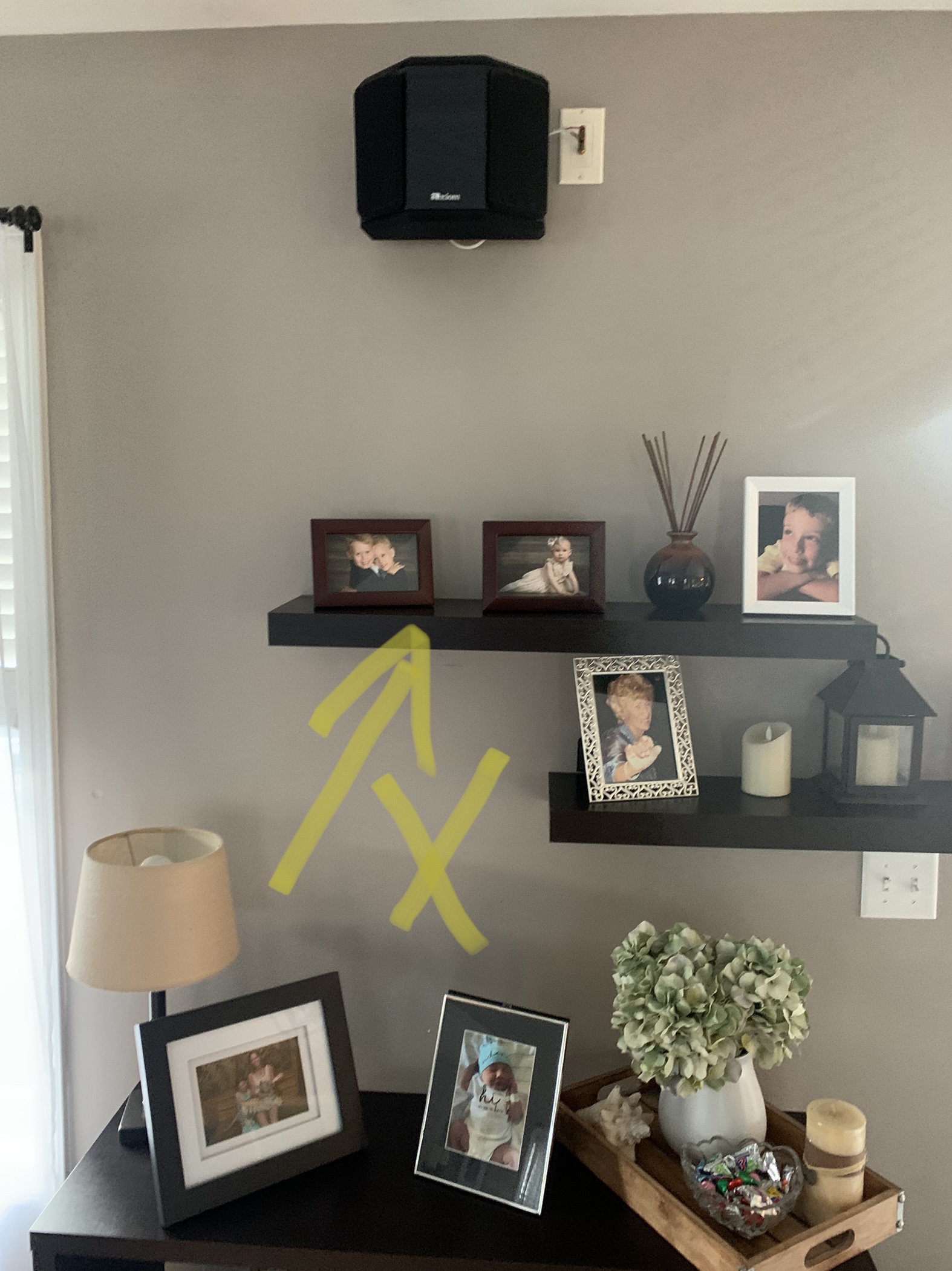

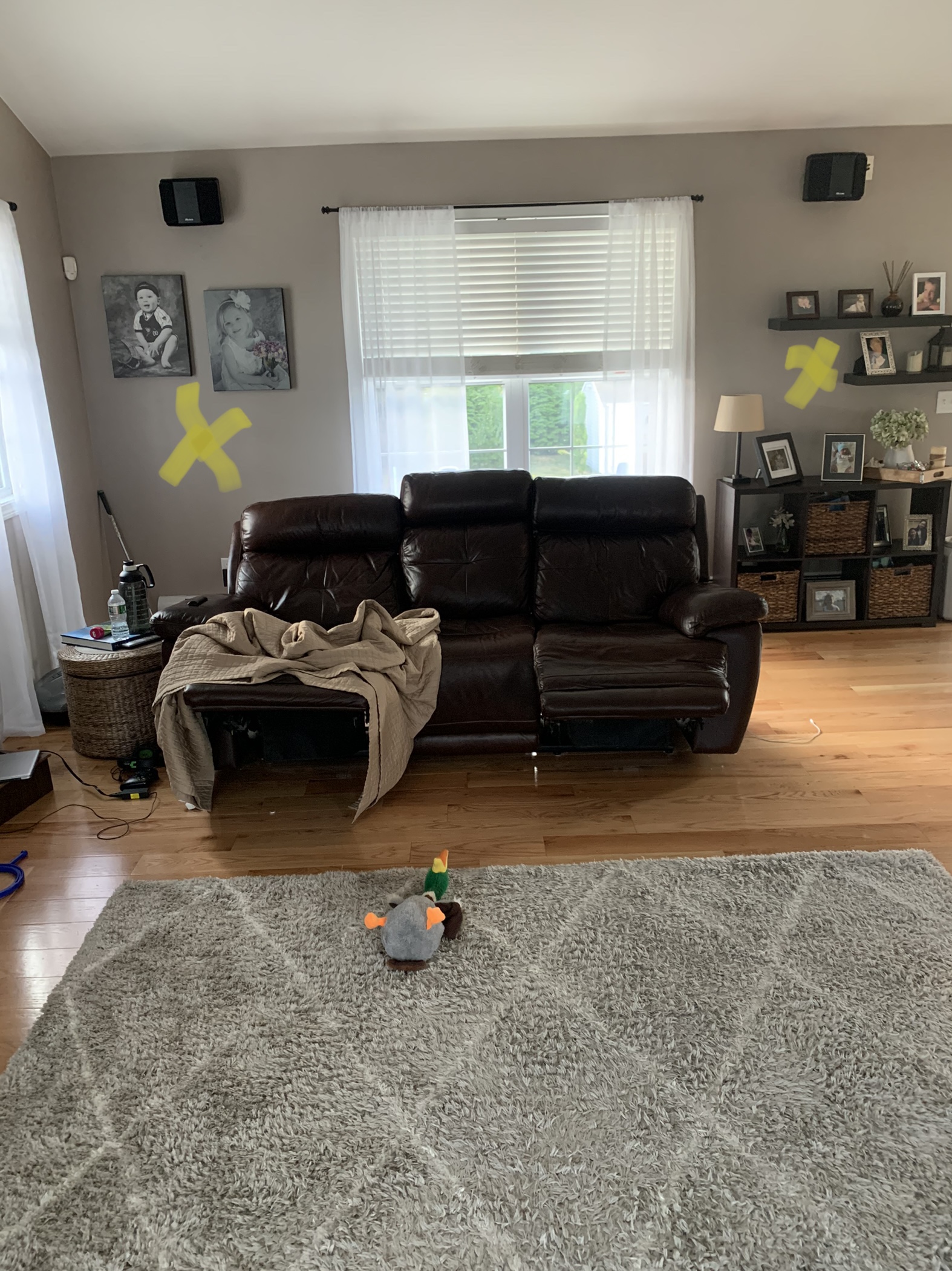

Here are some before photos. I may be limited how far down I can move them. I have that shelf that I don’t think my wife would be happy about me moving. The pictures on the left at no problem to move. So I’ll either move the new surrounds down a foot or I can place the surround just under the shelf. C05B71CB-DFEB-4787-8B11-8364C1BC737A.jpeg1EF89273-9C18-49EF-8436-BCDB0CDF9DBA.jpeg

Thanks I just ordered the mounts! Got the B tech b77
I have those and while they work (at least for my prime bookshelf) and I couldn't find anything better, they are rather unstable and allow the speaker to wobble. You will either have to find a way to make the speaker shake less, live with the fact it might have some resonances at some frequencies at high volumes, or find a different mount.
But yes, as said, there is no built-in feature that helps you wall mount those speakers, and you will need a "generic" mount that can "grip" any speaker of that size.
As for the shelves, you can probably easily just remove them and place them somewhere else, not near the speaker... And can't you replace the wire?
moreira85
I did mount them tonight and very happy with them. They are very secure and don’t wobble. I just have to wire them up and take down old speakers.
replace all the wiring? Not really I don’t it would be quite the project to Re run all that wire over the rafters or under the finished garage. I don’t have access above that vaulted ceiling to get up there. Also can’t really move that shelf at the moment as my wife wants it there.
