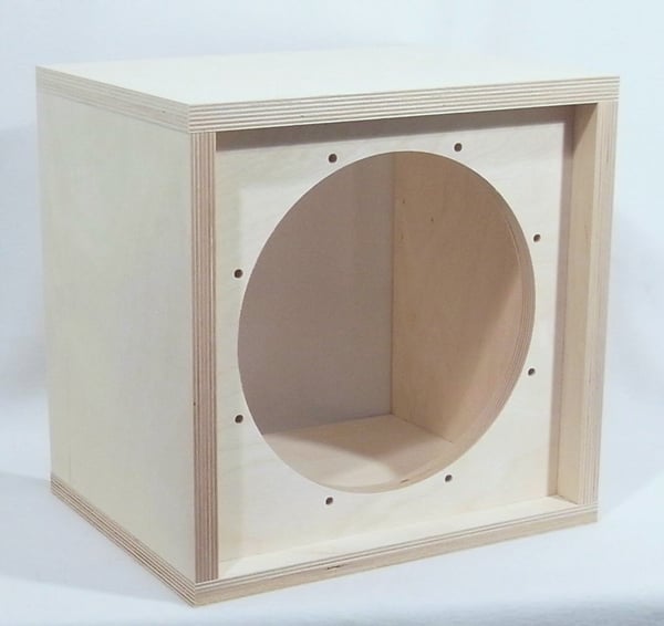

I'd read some of Linkwitz notes but his thought was open baffle subs for his didpole and other speakers. His LX sub and a minidsp would work well, but as mentioned by the others, it isn't plug and play by any means.
The sub kit which is out of stock because of price of lumber but still can be built.
Edit: the GR sub mentioned will work, but his flat packs are expensive too and you'll pay a premium for it to be finished by Danny and you still need EQ.
