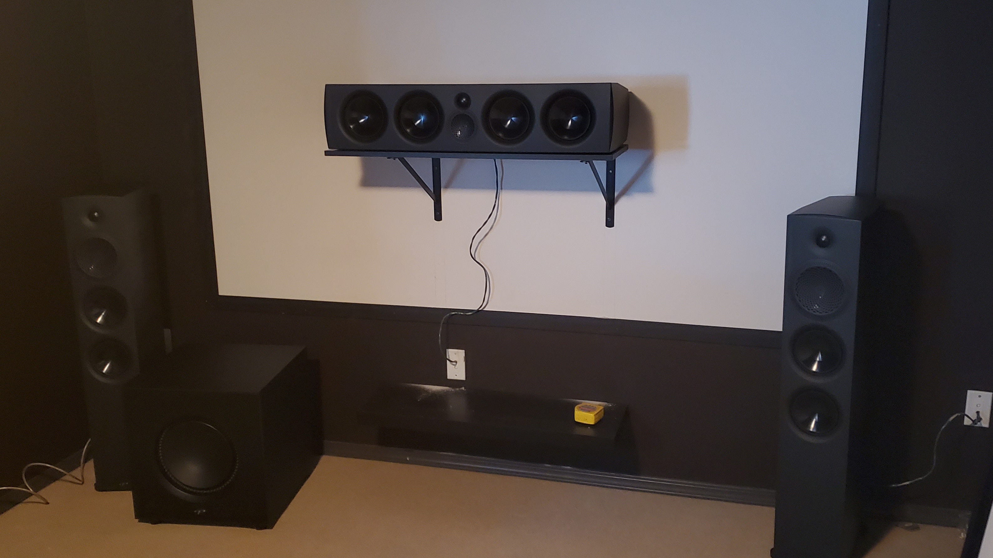

Some new images. Started setting up my gear to mount the ATS this weekend.

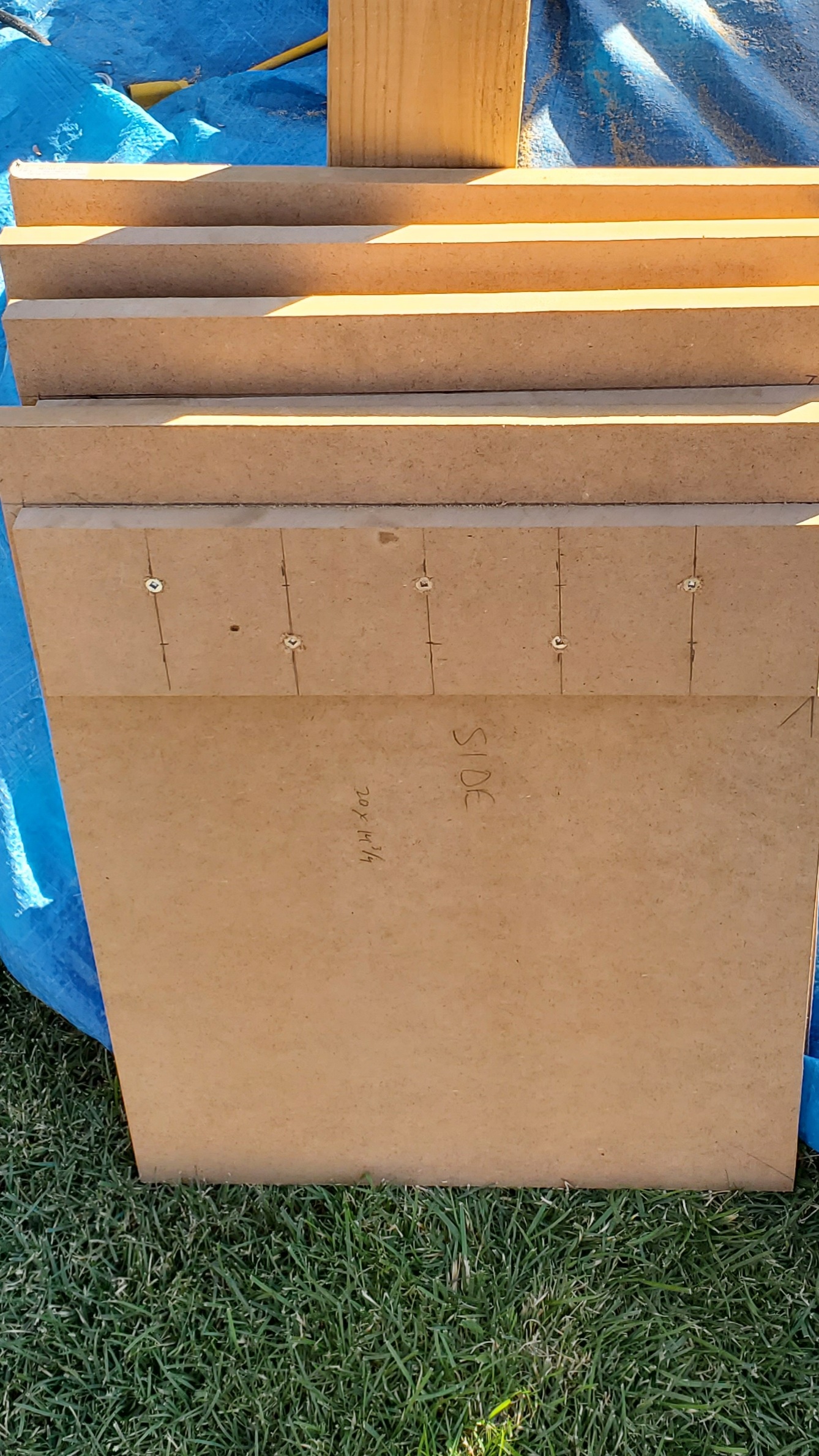

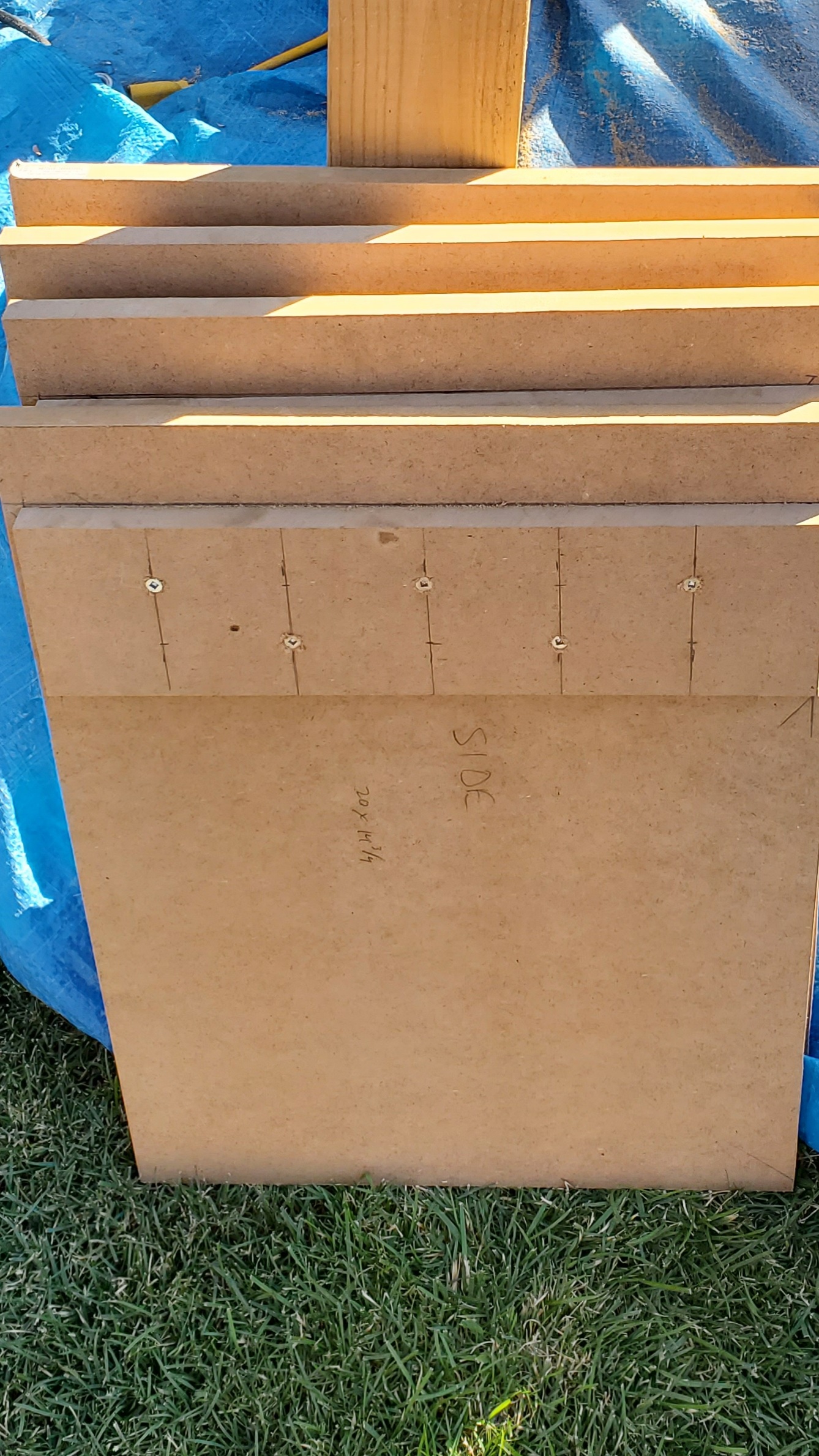

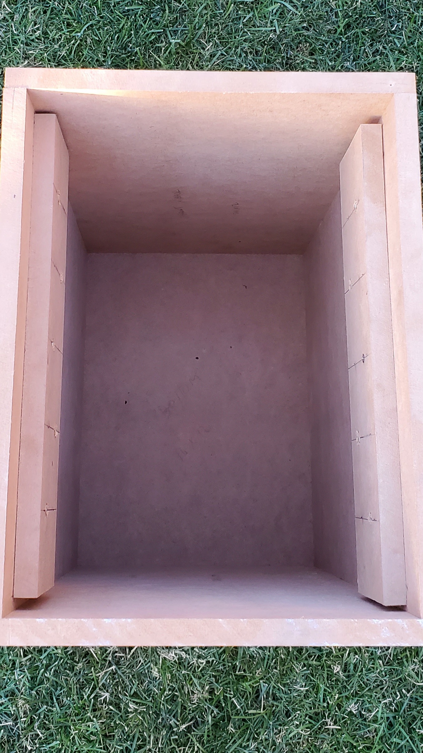

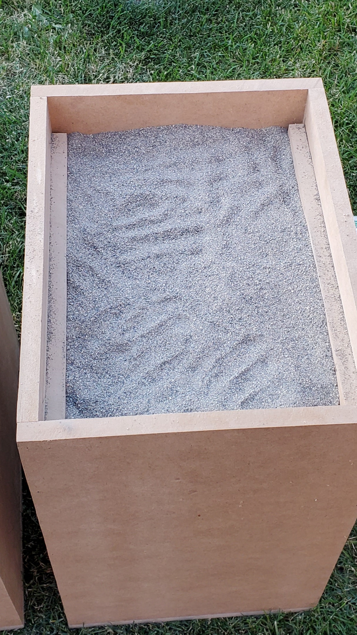

I'll post more pics later of the mounted screen. Also, I wanted to raise the L/R speakers. Couldn't find any speaker stands that were capable of handling the weight (none that I could get easily and quickly anyway), so I started building my own. 5/8" MDF 12" w × 15.75" d × 20" h. I'll fill them with sand:
There is a lid with a 2" hole and a 3mm rubber mat on top. I'm going to sand and paint them as well as add some kind of feet to the bottom. I'll also post pics of the finished product once I'm done.
I like it I built sand boxes for my towers and subs I think it does wonders for improvement in the deadening of vibration for large towers and especially subs . I believe it completely decouples them from the floor my sub boxes finished out at 80 lbs and the boxes for the towers are around 35 lbs . That’s a great looking setup you got .

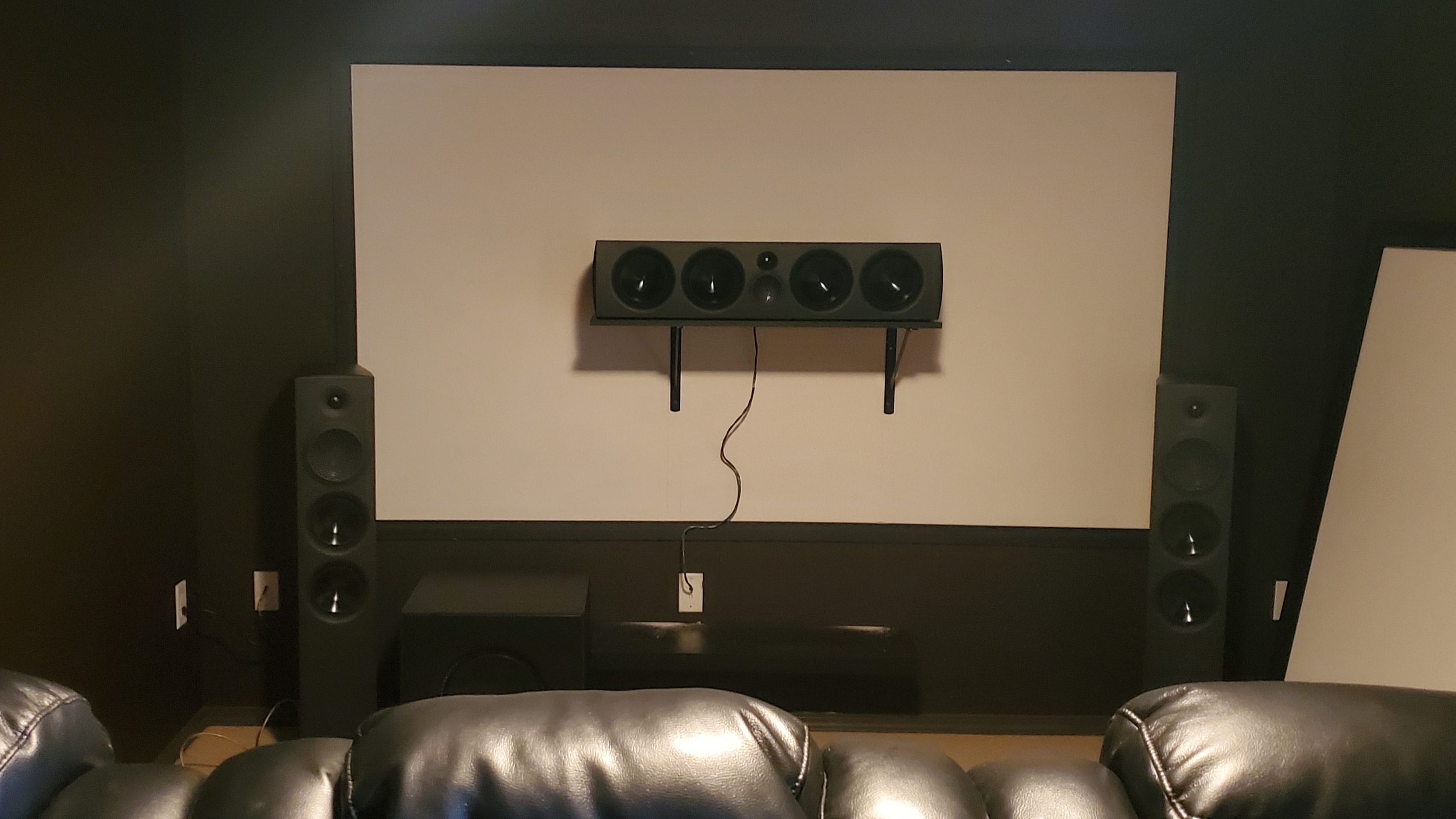

The center is high, but in relation the the seating positions with my 2 rows of seating, it sits just above ear level for the front row and just below ear level for the back row.

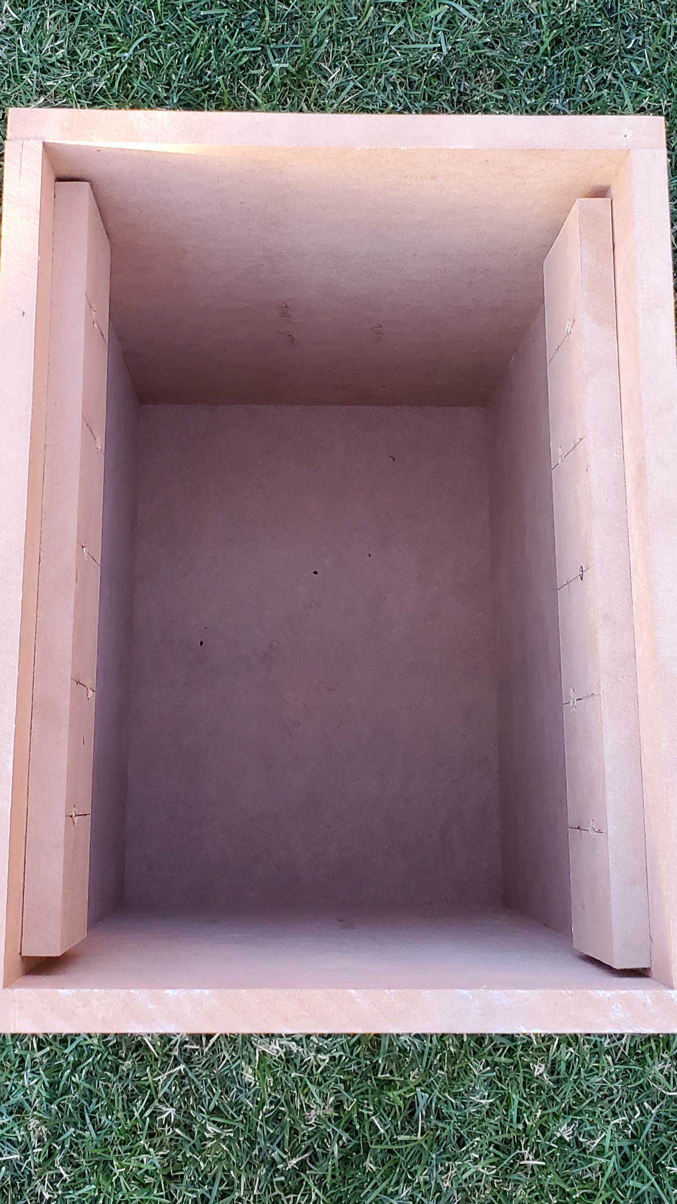

Just need to get the L/R risers/stands finished up to that level now. I built the first one last night. Pieces are cut for the second, just didn't have time to assemble it last night. Still need to sand and paint, and fill with sand. Should have that all done before Thursday when my new Epson 5050 is supposed to arrive. Just in time for Black Widow on Friday night :cool:

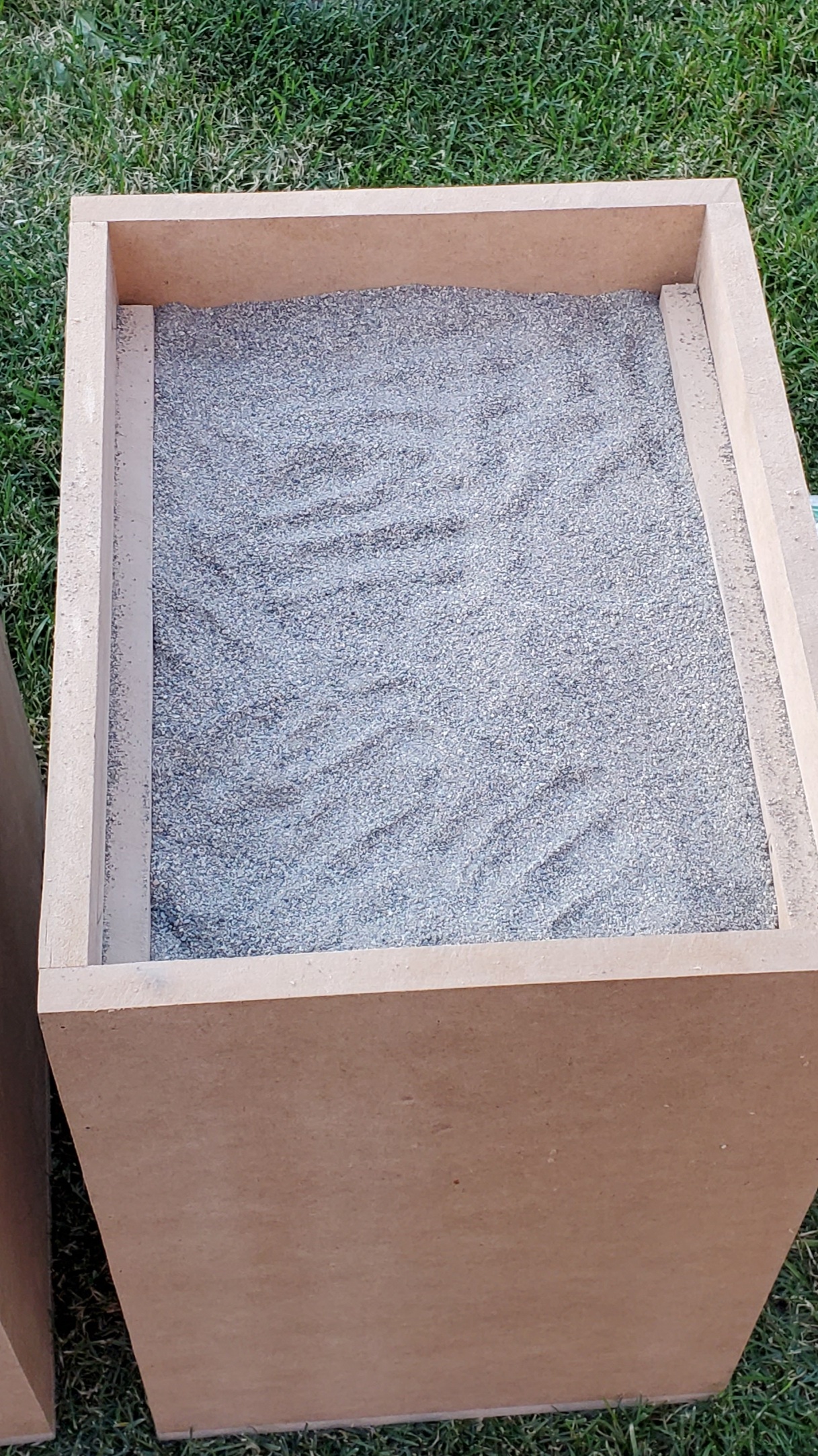

Second box built now. Went and got some sand to see how much it would take to fill. Holy crap. There is about 150lbs of sand to fill the box. Yes, 150lbs. It took 2 × 25kg/55lb bags, plus about 80% of a third one.

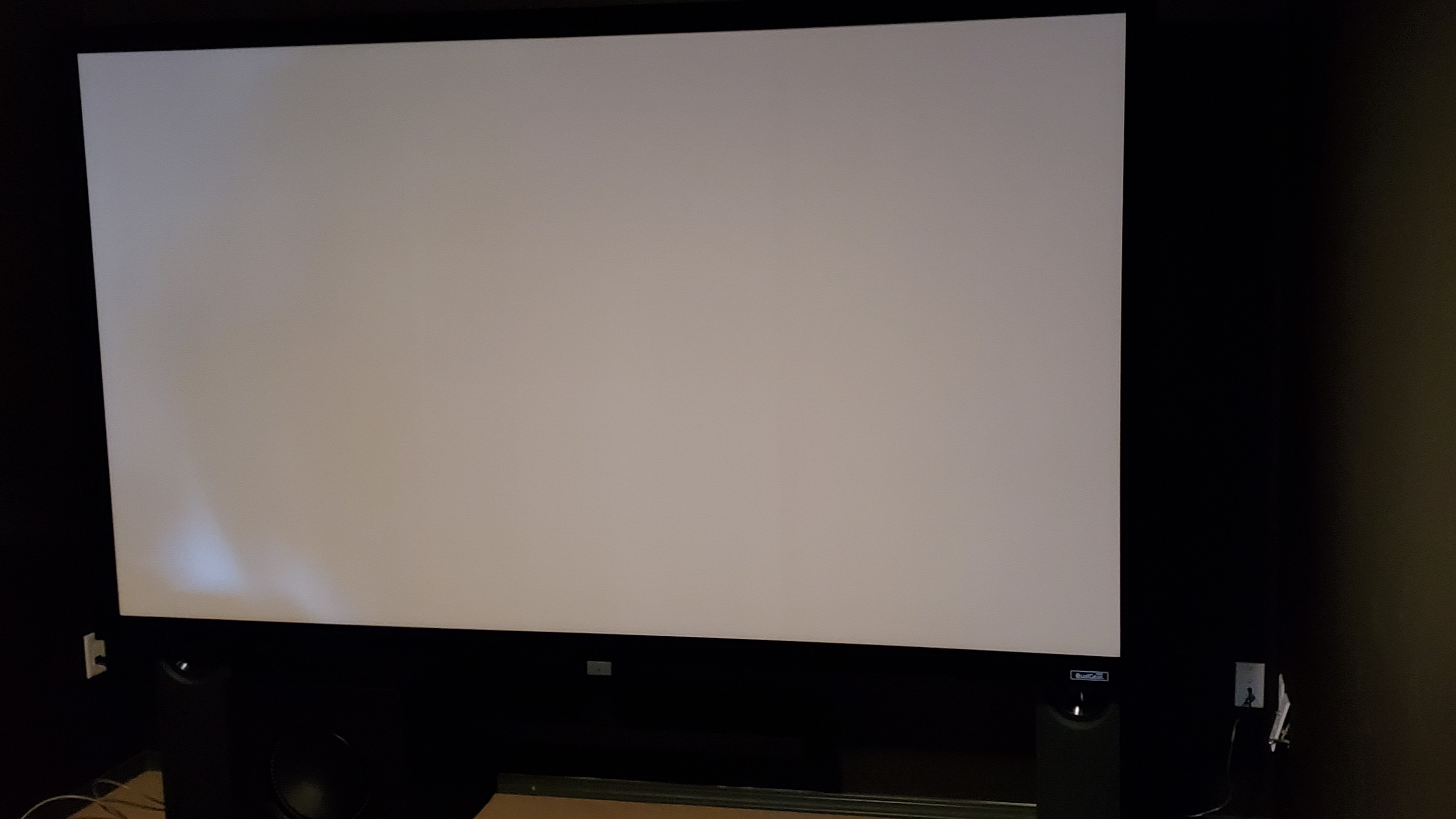

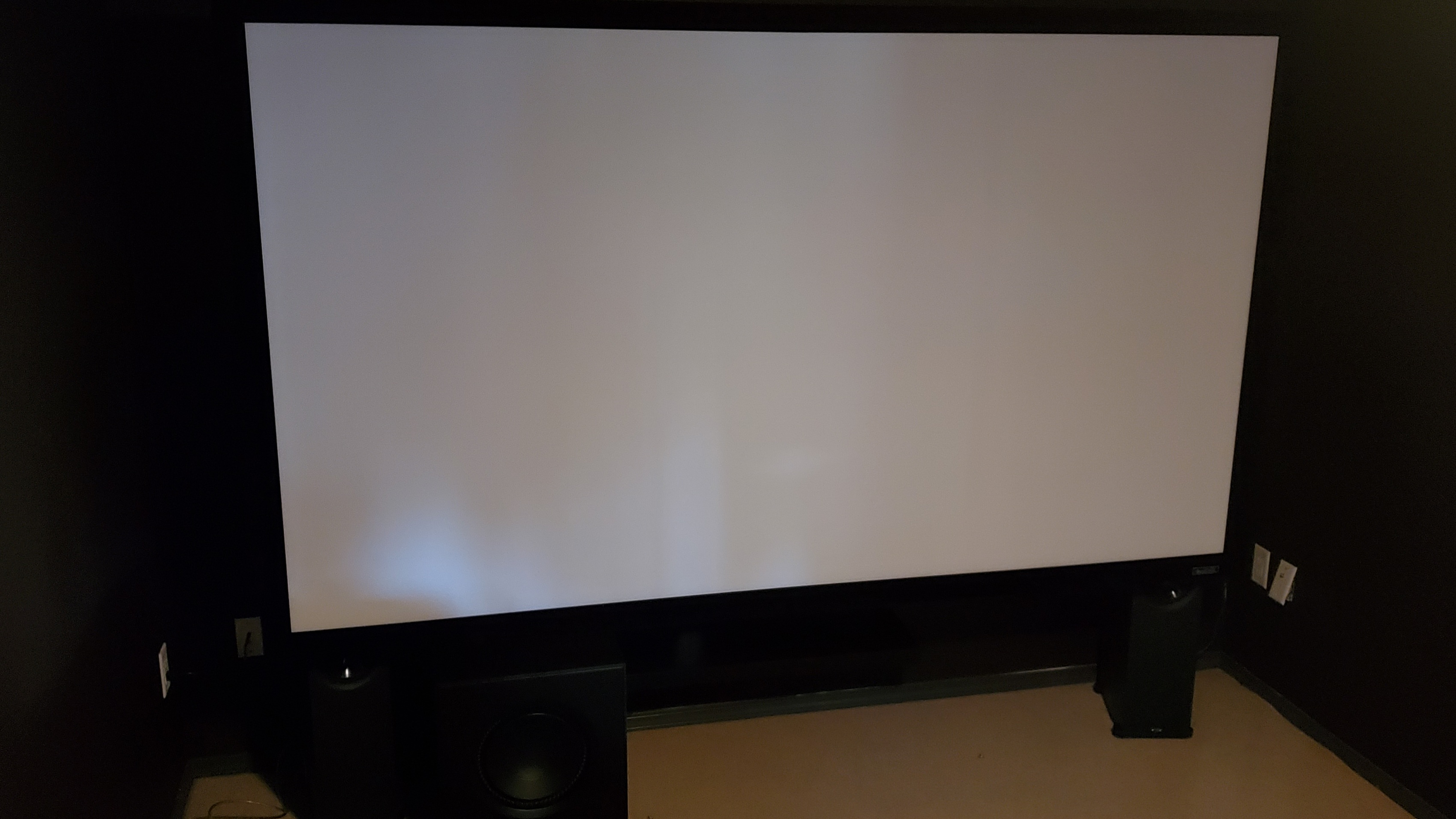

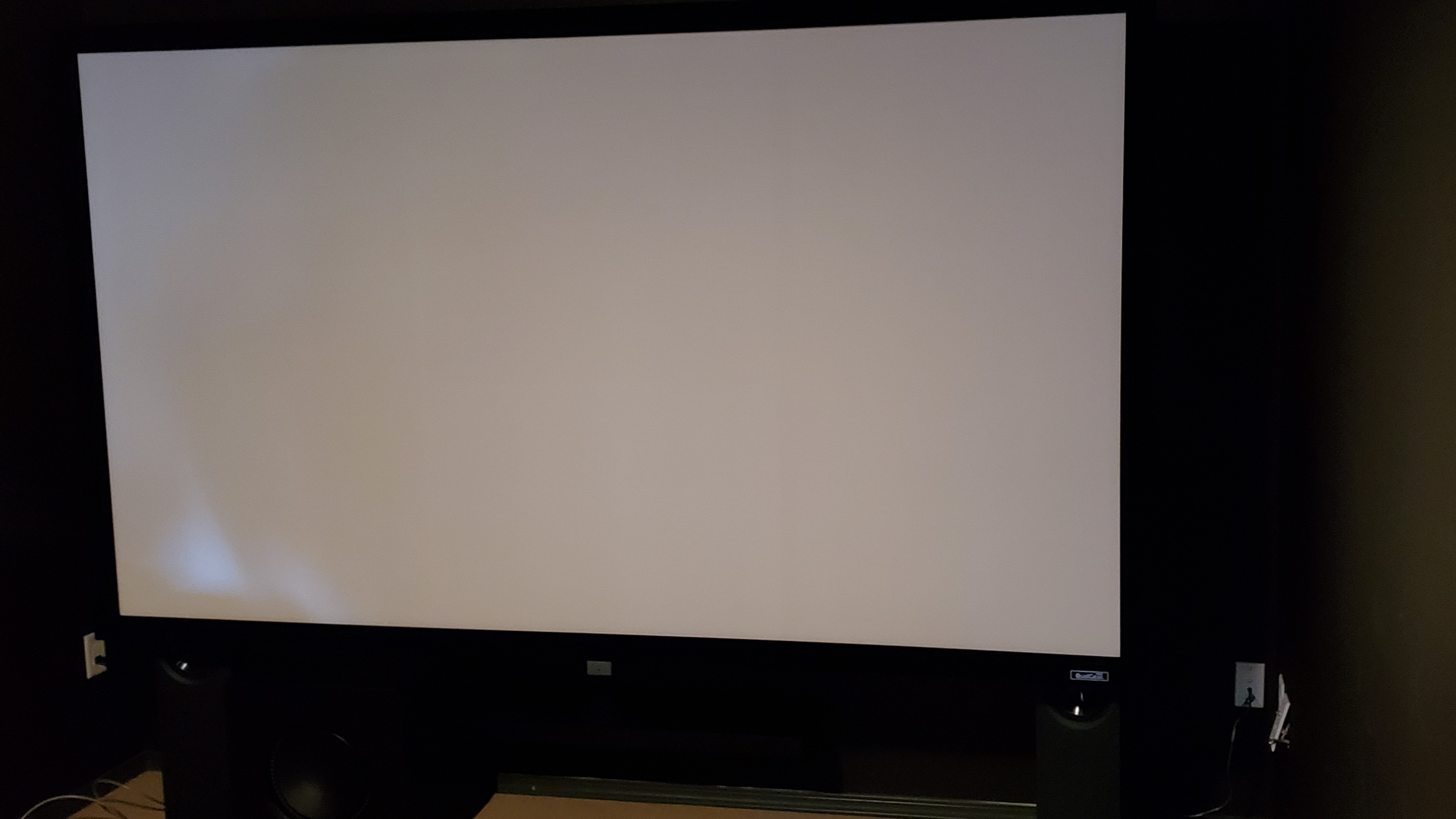

Pics of the mounted screen:
I still have to attach the bottom of the screen to the brackets. I needed another steel bar for that, but Home Depot only had 1 in stock. Had to run to Lowes tonight (where I got the sand) and grab another one. I'll post pics of the bracket system I rigged together to mount the screen once I take it down to put on the bottom bar on.

Ya may want to paint them with out the sand in them I thought mine were insanely heavy at 80 lbs I can’t imagine moving them bad boys into place . Nice work by the way your efforts near my tweaking approval ;-)

Why so much sand?
If you are worried about resonance issues, use cross braces.
I get making certain the stack isn’t insanely top heavy but you should be able to successfully balance that need with a half bag of sand. :)

I definitely didn't plan on that much sand, it was just a function of the size that the boxes ended up being. That being said, I'm not worried about it. They'll be nice and stable anyway.
I made some small risers for my towers I use as surrounds and filled them with sand, took 50lbs each and that didn't quite fill them....and I did it for raising them up primarily, the sand more for stability as I compared to a hollow box and made no difference to my ears (but have rubber feet on the speakers, too). The next riser I built for my center I didn't bother with sand but it's not in a place where it's likely to get knocked into compared to the surrounds....

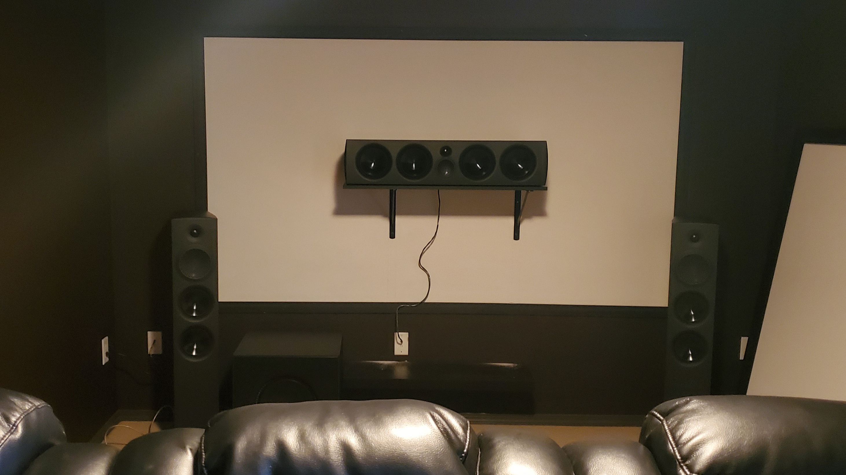

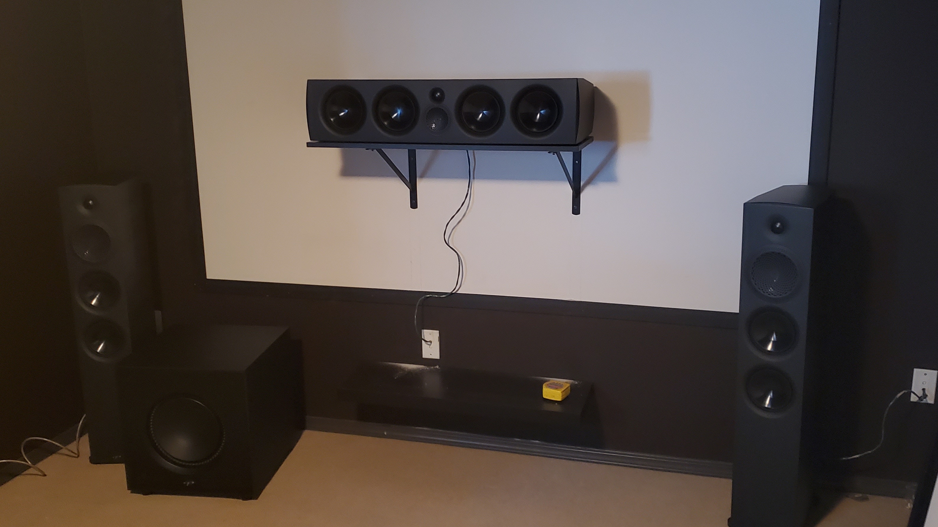

More pics of my madness :eek: speakers are now ~20" off the ground.
I decided to install the stands/risers tonight before I paint them. Due to my upcoming schedule, it's going to be a minimum of 6 weeks before I'll have time to paint them. Couldn't wait that long to install them.
2nd pic gives you an idea of my mounting system I made. 4 × 20" wall brackets, with a piece of slotted steel 8' long to mount the screen to. Each bracket can hold 250lbs when installed into a wall stud (which I did). So my ~40 ish lb screen is secure lol.
I might actually cut the boxes down. But for now, I'll leave them be.
