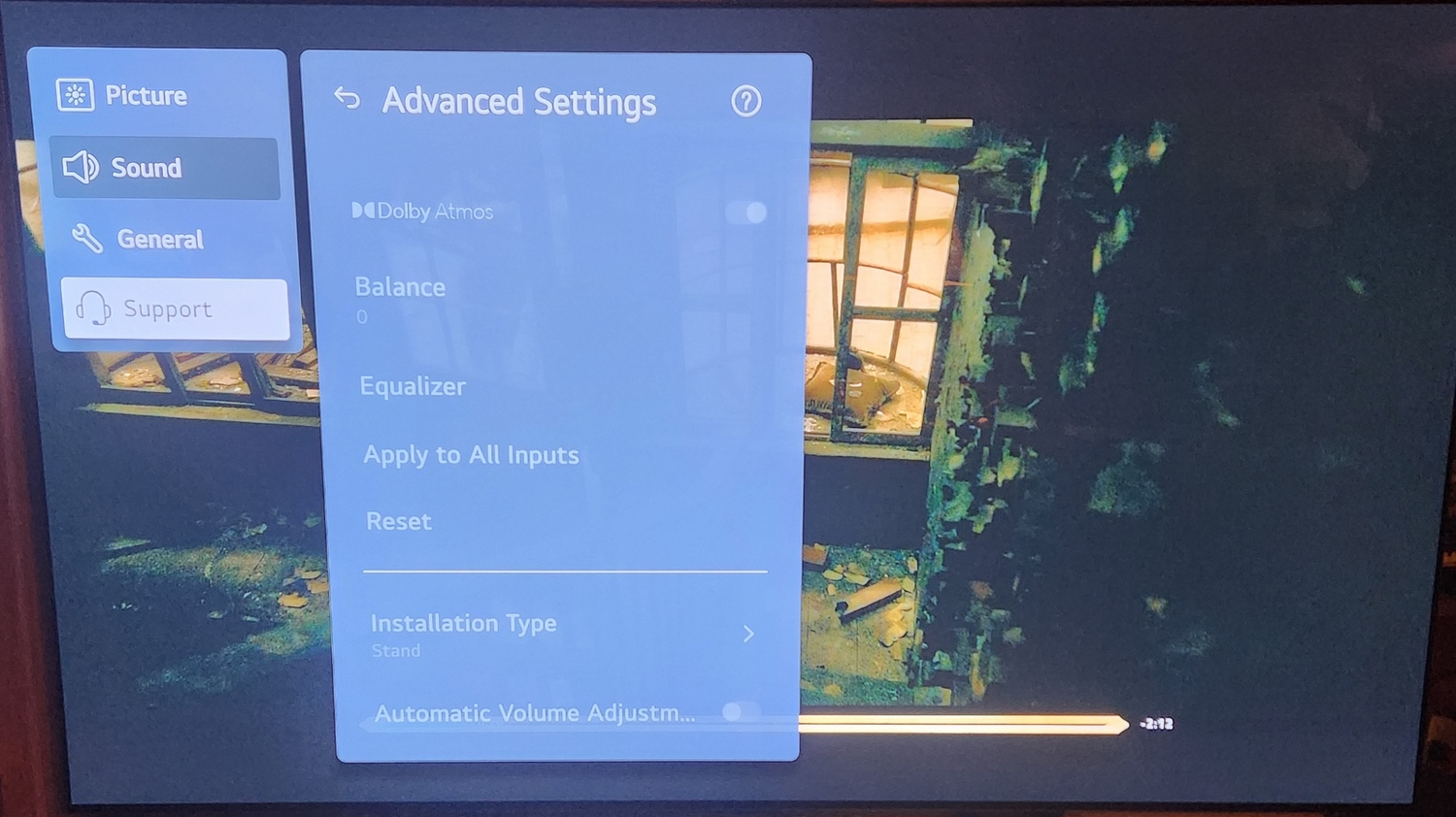

I was able to set the LG C2 TV to PCM output on optical. Navagating the settings menus don't get me there. Instructions don't match the menu as is typical with electronics.
I searched for PCM in the TV setting and it showed the instructions that don't get me to the options but it has a "Try it" button and that brought me to the final setting and let me set it to PCM instread of AUTO. I didn't notice a sound difference with a movie and still the soundbar. That's fine. The TV is now set to PCM.

LG’s settings need lots of work. For Sound settings, go to All Settings>Sound>Advanced Settings> Digital Sound Output>PCM.
All Settings>Sound>Advanced Settings> All grayed out and Digital Sound Output does not exist
I've used the same steps but it doesn't work. There are two problems.
1 is that the whole "Advanced Setting" have been disabled by something, some setting most likely.
2 Digital Sound Output>PCM isn't listed.
Fortunately if you click the ? you can search PCM and get brought to the final setting PCM or Auto or somethingelse. So it's set.

Your set is not receiving instructions via optical cable, optical tells the set nothing. (another good reason to switch to EARC/ARC)
In most cases your set will receive instructions via EDID from the audio device as to what the audio device is capable of. (when using HDMI)
In this case, your LG has no idea whether its hooked into a 2 channel, 5.1 channel, Atmos or whatever.
Just for fun....hook into your soundbar via HDMI....I would bet all your audio settings come to life.
Getting that EQ to work via the LG's output would be nice...not sure if that will work that way though....a lot of settings are just for internal speakers on a tv set.

Apologies, the settings I suggested are to be set after assigning the optical port by going to All Settings>Sound>Sound Out>Use Wired Speaker>Optical Out Device. Once set up there, the other settings will be applicable but you need to scroll down the menu to see them.

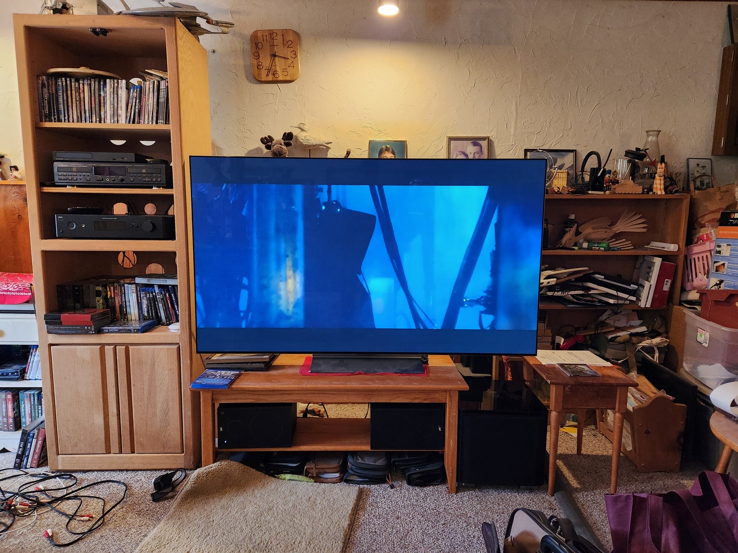

Well I went and did it. Not exactly what I was planning.
I got the PSB Alpha AM5 powered speakers.
They didn't have the PSB subwoofer handy so I ended up getting a REL HT/1003 MKII powered subwoofer
They sound good in this placement but I didn't anticipate two things.
1: line of sight for the remote to the left speaker is not good from my desk and
2 I can't hear the tweeter on the right speaker form my desk chair.
So I'm taking a break and then I plan to put the left speaker on the shelf below the NAD where the DVDs are now and put the right speaker on that small table next to the subwoofer. I think overall convenience and sound will improve.
My only concern is the pesky cat trying to jump onto the right speaker. This is Chester the Tank cat. I could also put the right speaker on the shelf in back of the small table but that might make it sound a bit wonky. I'd have better line of sight to the tweeter up there but the two speakers will be at different heights. Or I could also totally rearrange the stereo components and put the left speaker where the two stacks of components are but that's for a different day.
I may plan to just get a longer and slightly taller table to put the TV on that is long enough to put the right speaker next to the TV.
It all makes it a little harder for me to get in back to play with wires but that's really a clutter problem.
OK. I've taken a rest. I think I'll move the two speakers.

The REL is a fine sub.....better than the PSB you were considering.
Why not use one of these and just raise the tv and put the speakers up on top ?
