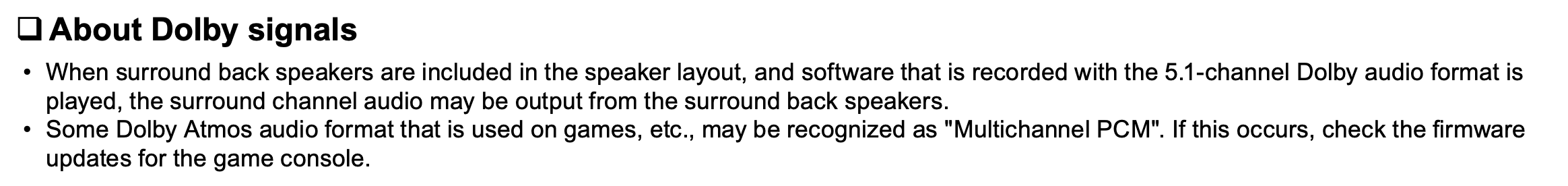

Onkyo TX-NR6050 Manual, Page 139:

Actually, you didn't know it from the get go and said you hadn't experienced it. No biggy, but we did discuss it over in your other thread:
Trebdp83 said:
in a case involving a Dolby Digital signal and a sound mode selection of just DD and not Dolby Surround using a 7.1 configuration , the surround speakers may not produce sound. I've experienced it and it is an issue going back years with Onkyo models.
