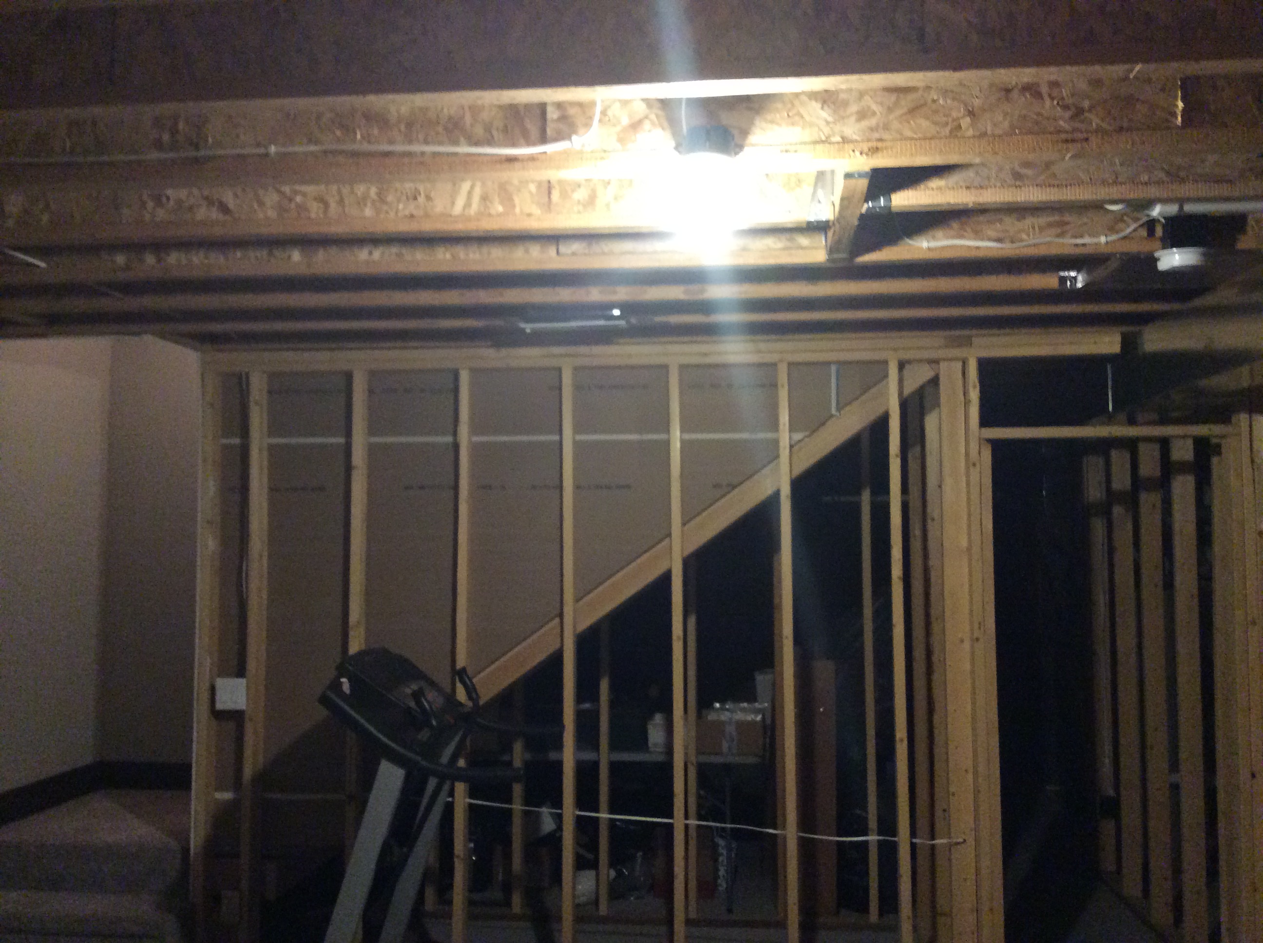

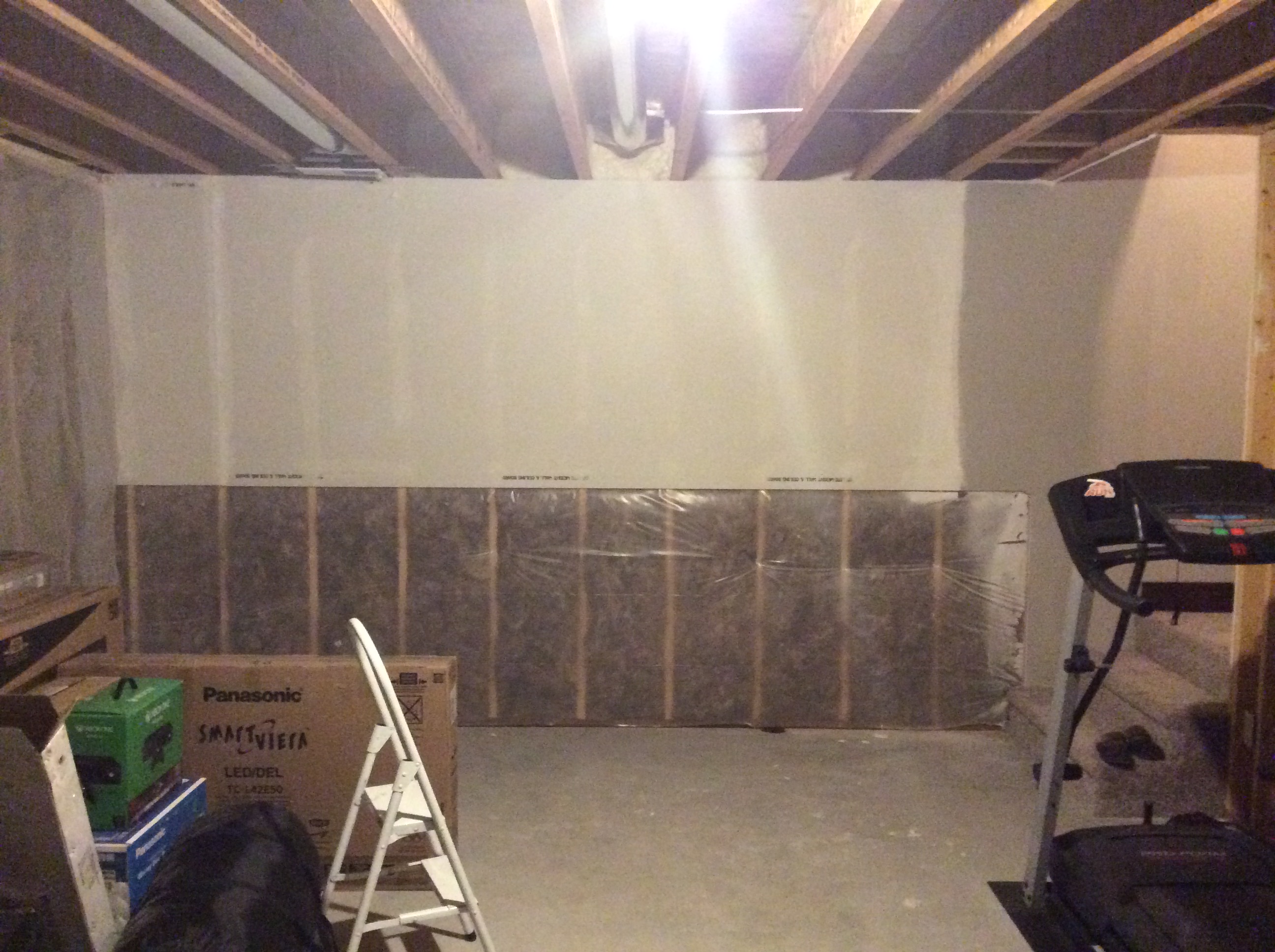

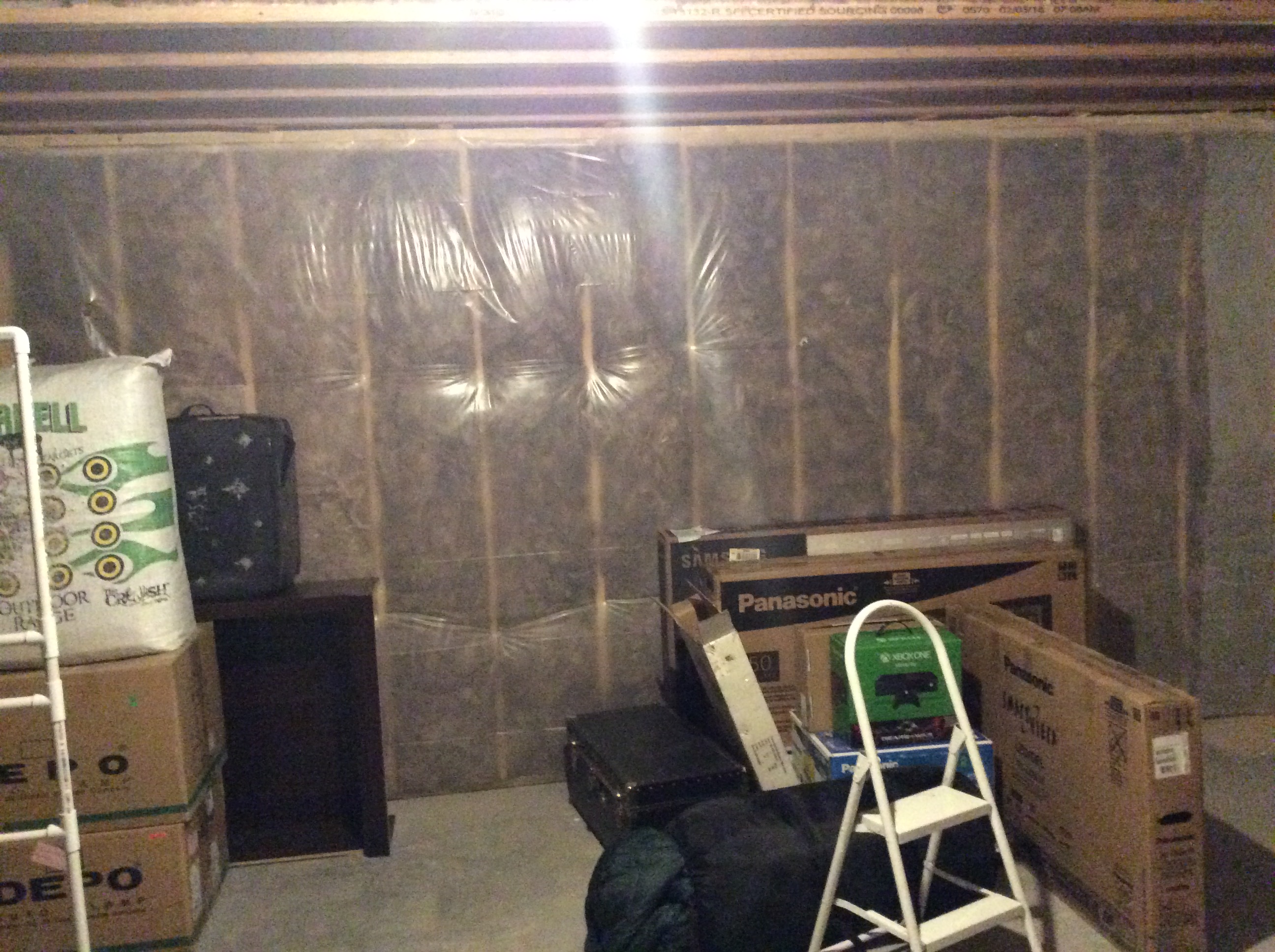

Please forgive the clutter and archery target.
First pic is towards the front of the room.
2nd pic is from left facing right.
3rd is from front of room to back
Last is from right of room to left
My idea is to have screen at front of room then build out cabinet space for components. The two open doorways towards the front of the room will have doors
