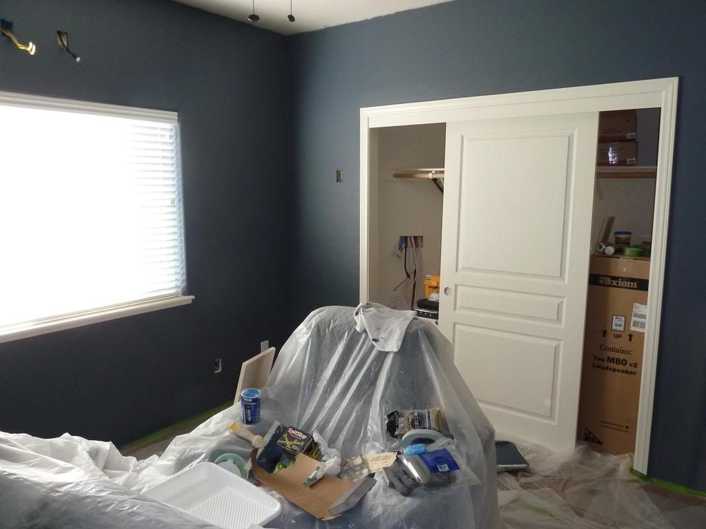

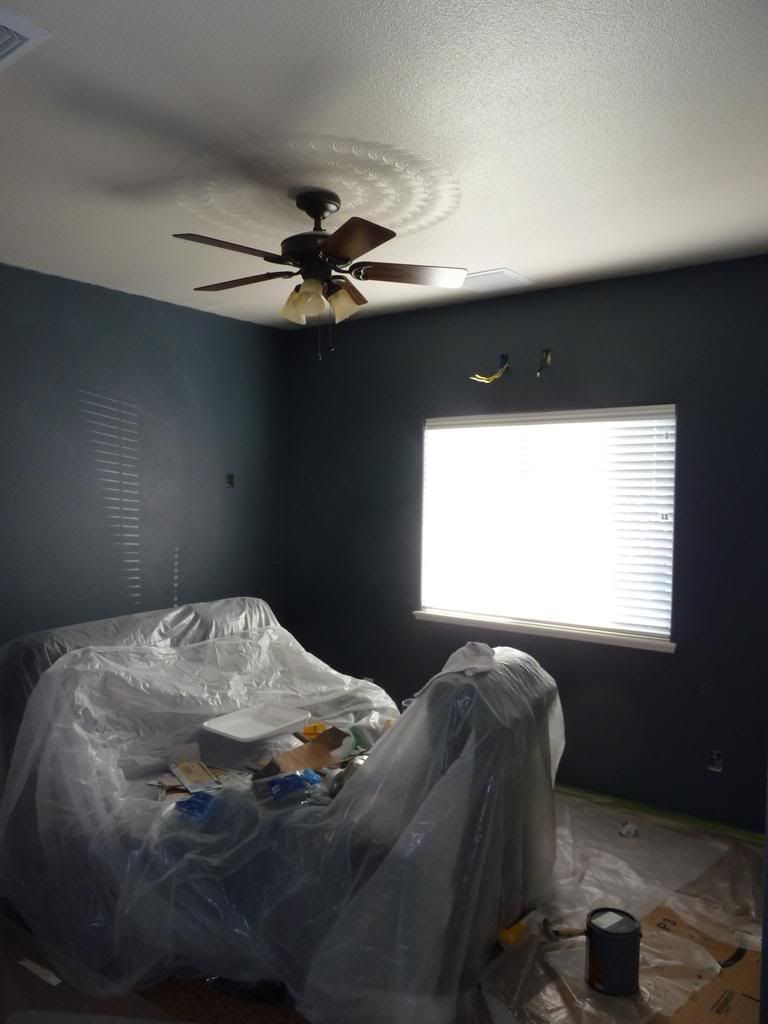

Well, remember this isn't my first rodeo by a long shot, so make sure you don't judge how it will look by that one picture I attached. As you know from my theater thread we are currently derailing, I am a fan of the adhesive-backed 45" wide rolls of thick velvet from McMaster-Carr, with which I covered my entire front wall at a fairly great cost. I haven't done any scientific tests on it or anything, but it will eat light better than almost anything else out there. The intent is to have all of the front of the room that isn't screen covered in this stuff, 6 feet back from the screen on the side walls and maybe even 10 feet back on the ceiling. Additionally, the carpet that is going in is almost black (slightly brown toned). We are going a fair distance to control stray light and maximize perceived contrast and brightness. Then there will be very dark, flat paint for the areas not covered in velvet. I would say my definition of bat cave and yours are closer than most, so sorry if I rounded up when I said 100% light controlled. :p
