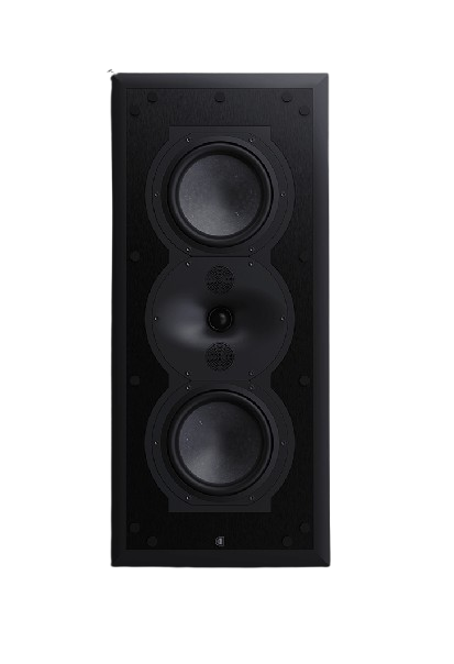

Just for fun, something like the monitor audio CP in-wall series might be fun. They come with an enclosed back at a price that seems to be within budget.
Surrounds
fronts if you still want in-wall
