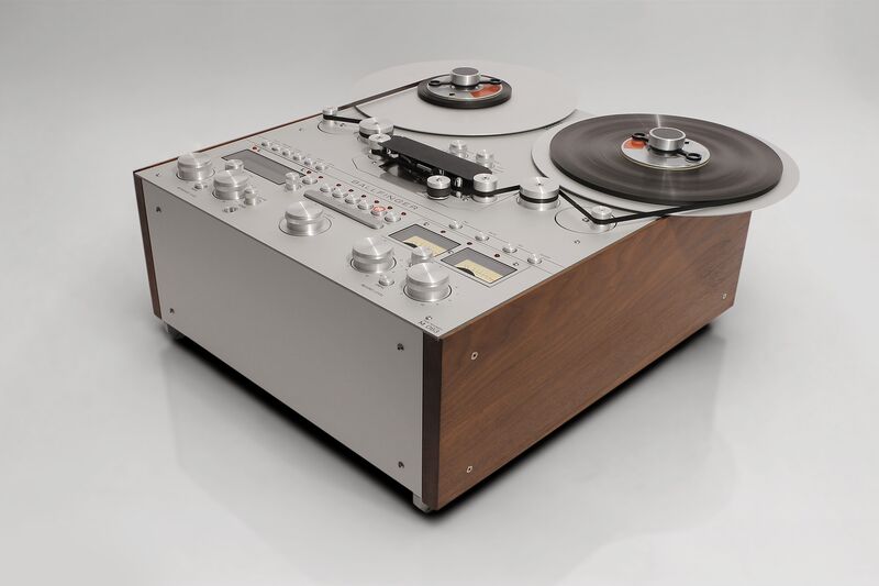

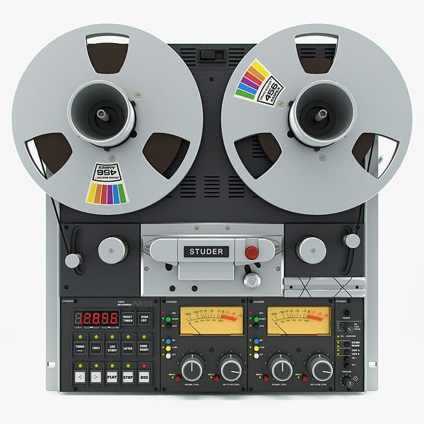

The machines are clearly Revox/Studer knock offs. The tape path is virtually identical to my Revox A700s.
That recorder
seems to have a lot on common with this Studer machine.
But I suppose if you are going to copy somebody, you might as well copy the best.
However ALL Studer and Revox machines were three motor.
