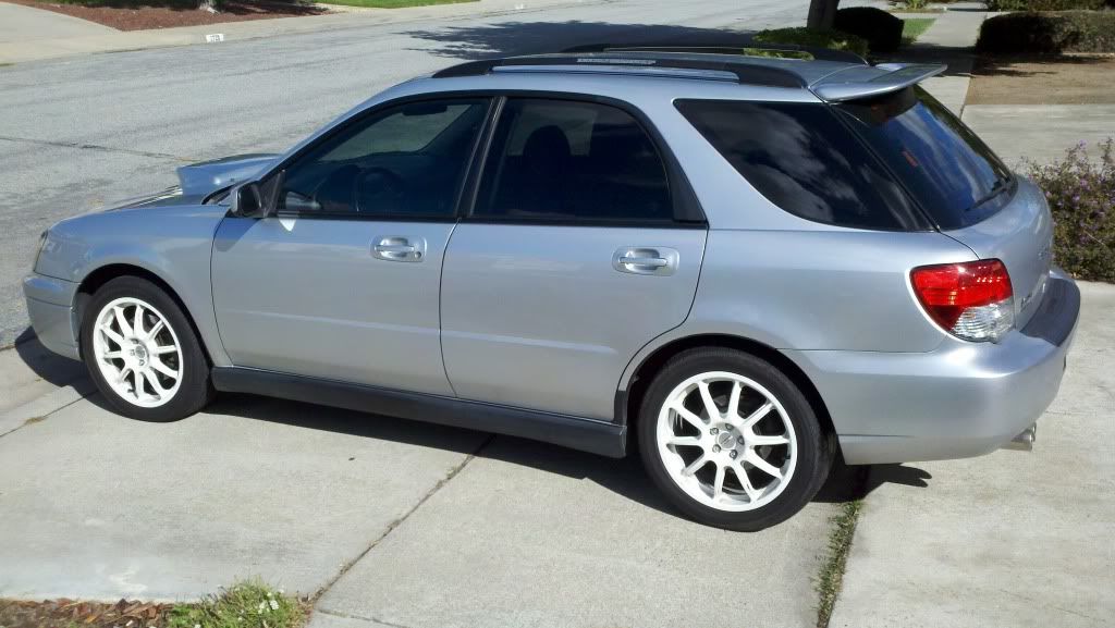

A local guy was offering up his rims for some others + cash. I happened to have the extra set with decent tires that were on there when I bought it so:
17" Prodrive P1s. The plan is to have them bead blasted and repainted or powder coated black or gunmetal in the near future.

Fresh pic:
I have a bunch of little stuff coming in this week. Lamin-X for the headlights, spline lugs for these rims, possibly a snorkel (resonator) delete...
I almost missed this part and was about to rant how ugly the white rim looks like :D (kinda reminds me of wheels on carriage)
Immo power-coated black is the way to go ...
Black is definitely my preference. The spline security lugs I bought are black also. Haha, they actually do look a bit like wagon wheels...:D

Just talked to the powder coater. A little more than I expected, but that includes stripping them first and masking the mounting surfaces. He had a number of other rims in there that they had just done and they look great.

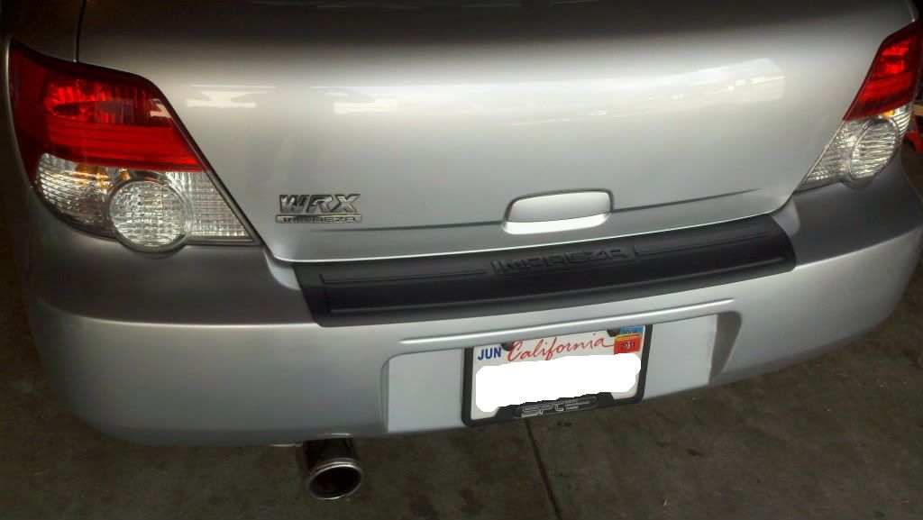

That is an OEM Subaru STI exhaust. Got it cheap used because the guy upgraded. Bolted right on. Full cat-back and larger than the WRX stock exhaust, but I didn't install the mid-pipe yet because I need a new donut gasket at the cat. Not the exhaust I wanted, but will tide me over until I can allocate the funds to the Borla Hush (3") cat back. :cool:

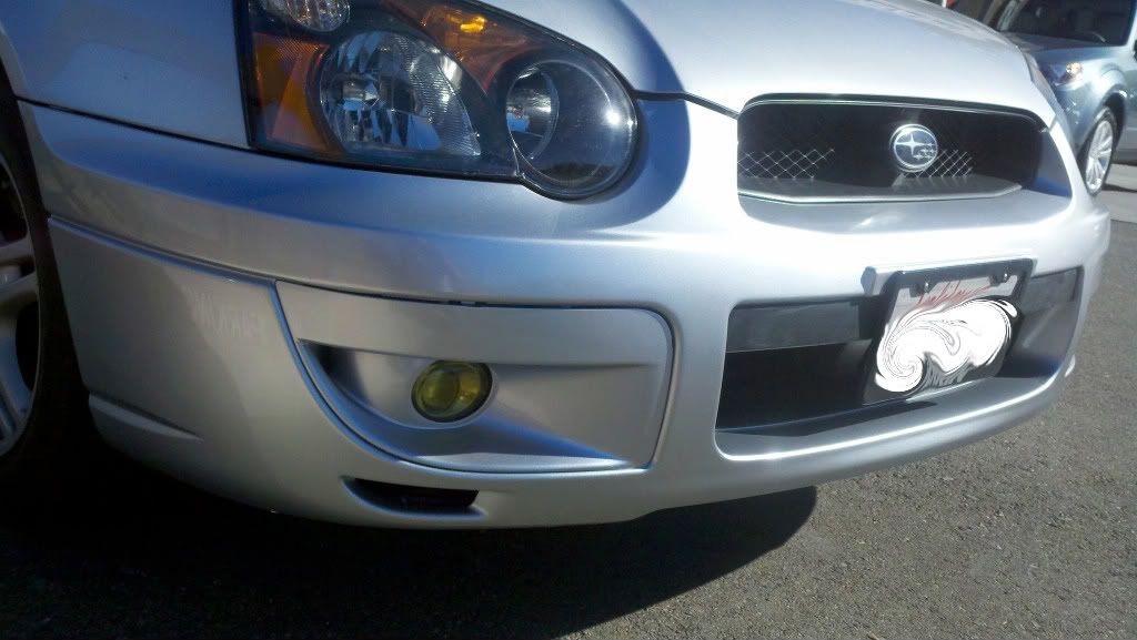

Dropped car off this weekend. I knew the car had been touched up, but the entire front bumper started to bubble and peel. I questioned the dealer's service manager and he said he wasn't aware the car had been painted, but when I dropped it off I ran into my salesperson and he said they were probably the ones who did it. I was pretty pissed, and I told him if they are having the same painter do it and they do it wrong again, that I would have my shop repaint it and I would send them the bill. This is an example of about a 2" section where the paint literally just flaked off:

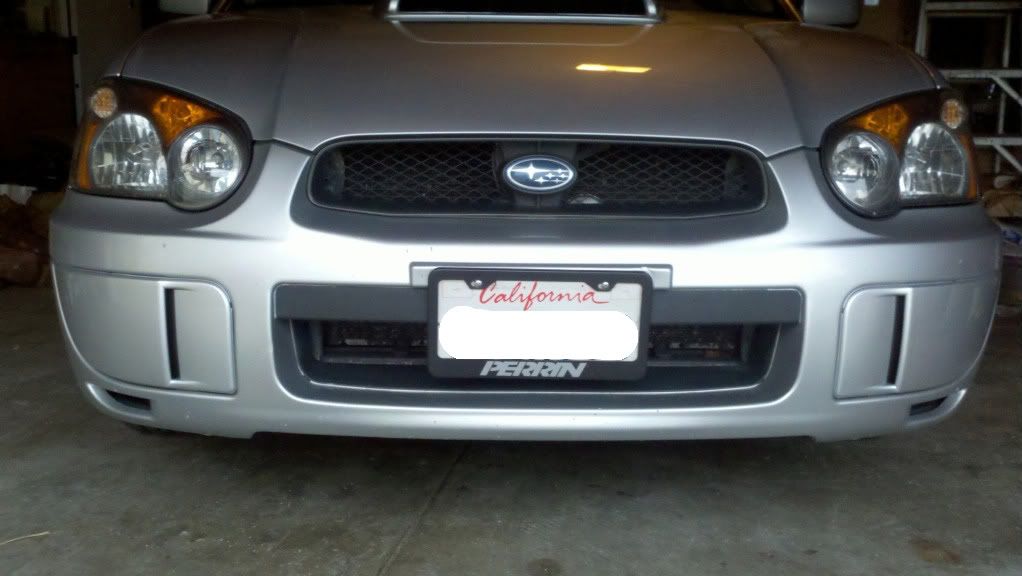

A few other additions:
STI fog covers:

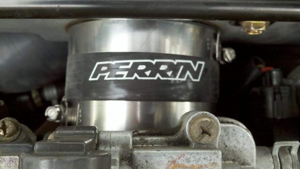

Perrin intercooler hose kit - made a very noticeable improvement.

Silver is the thinnest and physically lightest color for cars I have read, and that likely has something to do with it, but a good coat of quality wax over a good condition clear coat should keep it looking good for a long time. The paint on the rest of the car is in excellent condition comparatively; aside from the usual nicks on the hood, the paint on the metal has no flaking.
In this case, they just did a crappy job when they resprayed the bumper and/or forgot to put the flex agent in the paint. No flex agent on a poly bumper means the plastic will shrink/expand and the paint will peel.
