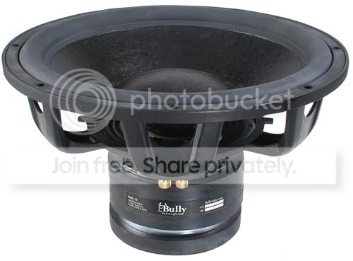

Sheep: The spider?
I mean, the basket looks cheaper, and the cone looks like it has less excursion.
The stamped baskets are definitely a bit less rugged. But you have to admit, the magnet structure on both the NSD and Plus resemble the Bully driver.
The inner cone has nothing to do with excursion. The surround and spider dictate Xmax. That's one heck of a surround if you ask me. It's about identical to the new Plus driver.
