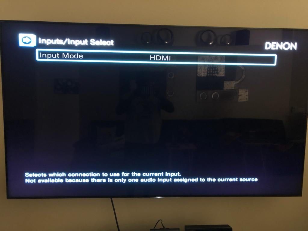

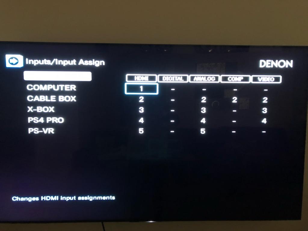

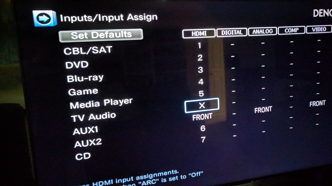

Those are my settings. I put TV and AVR. Again. Thanks to everyone giving me input.
PENG
There is a problem with your input assign settings. With ARC set to On, you should see and "X" automatically shows up on that screen under HDMI. Please see screen shot below:
What happened to your TV Audio input?

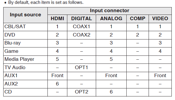

Also, see below copied/pasted from page 198 of the Owner's Manual:

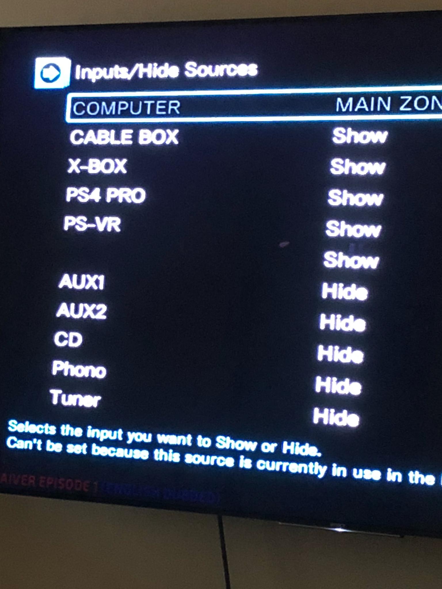

I hid the inputs not being used. But I dont even see that as an option on mine.
PENG

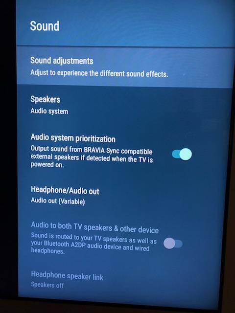

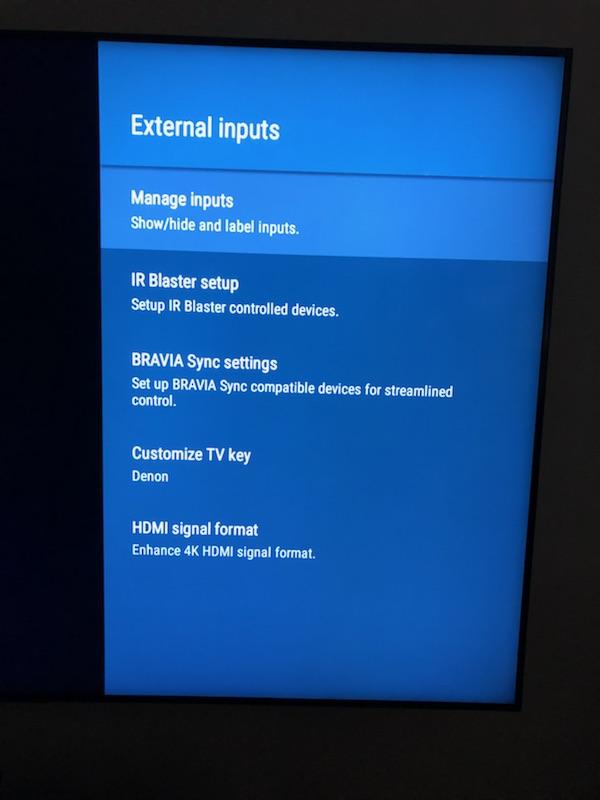

In order to use TV Audio you have to have one of the TV's audio output (optical, digital coax, or RCA) connected to the Denon's audio input. Otherwise you have to use ARC, and in that case, if you have the Denon's HDMI Monitor 1 (ARC) connected to the Sony's HDMI ARC input (for your model iirc, it's input 4, but it should be labelled so you can id it easily), then all you have to do it to setup HDMI as shown in the screen shots previously attached. Then go to input assign and you should see that you can no longer assign HDMI to TV Audio, as indicated by the "X", as shown in the screen shot I posted earlier.
You may have tried many things and something could have been messed up, it is time to do a reset of both the TV and Denon (may be just the TV first and see what happens). After resetting the Sony, you should clear the cache. https://www.sony.com/electronics/support/articles/00202472
