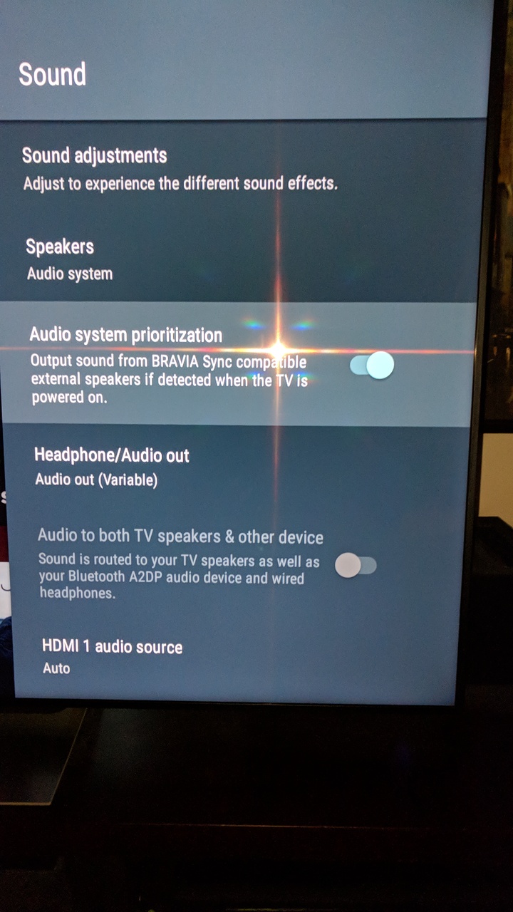

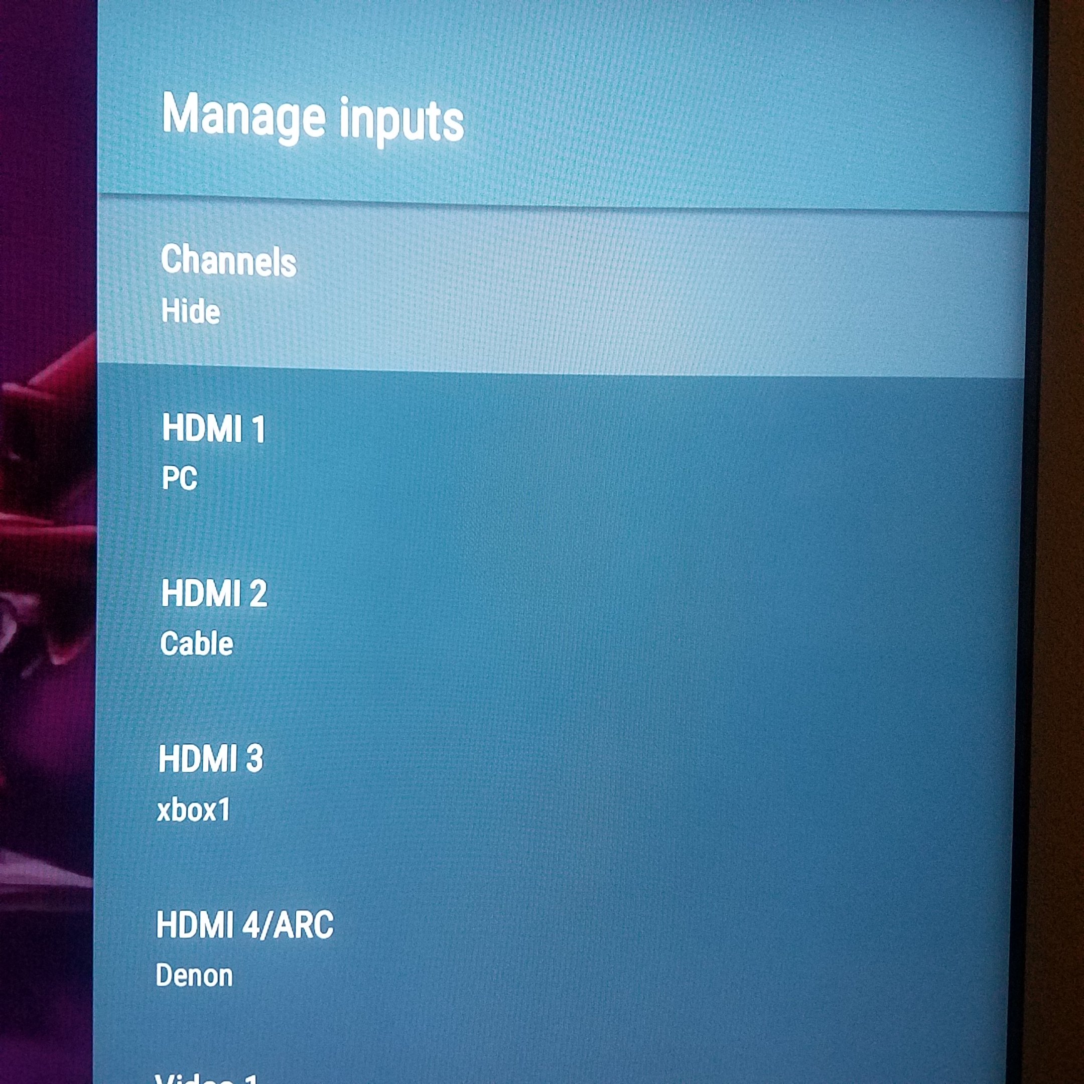

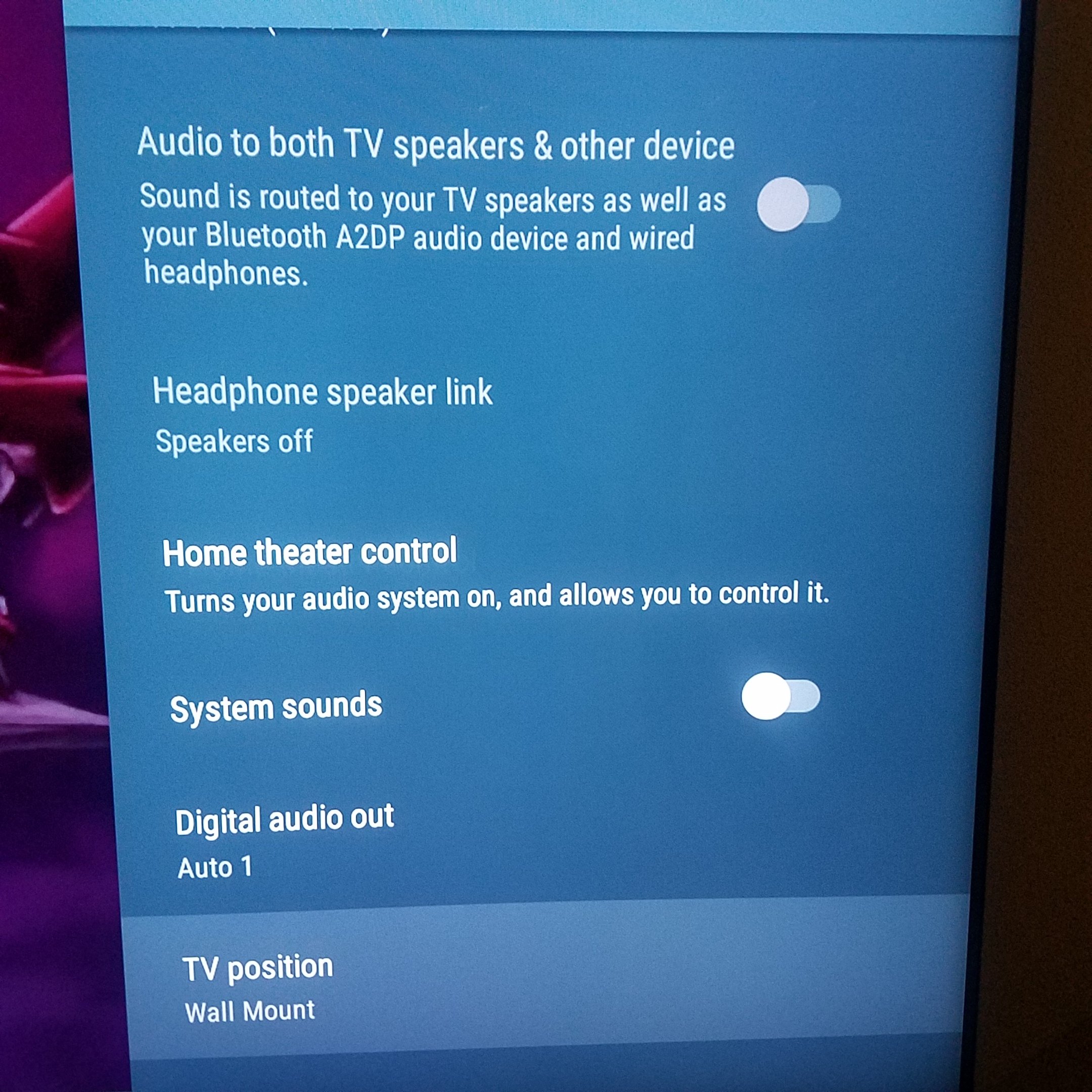

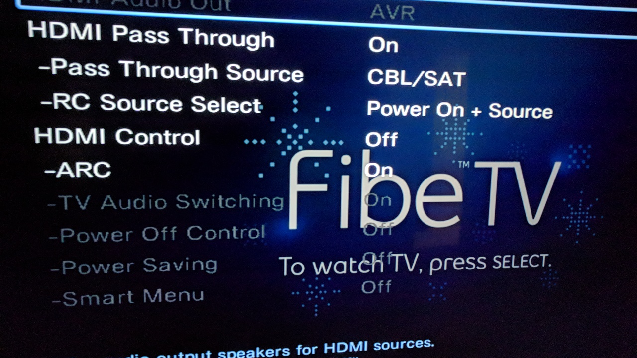

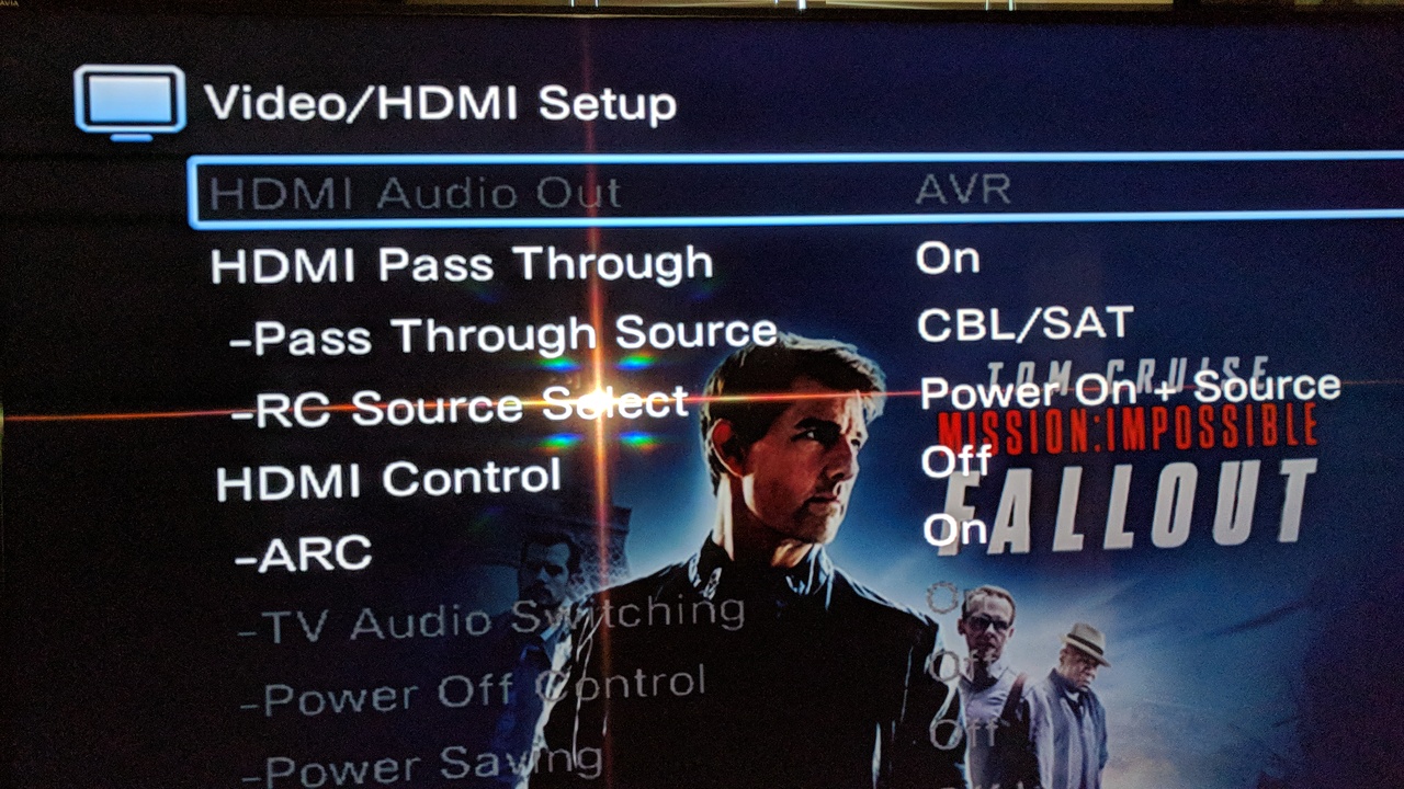

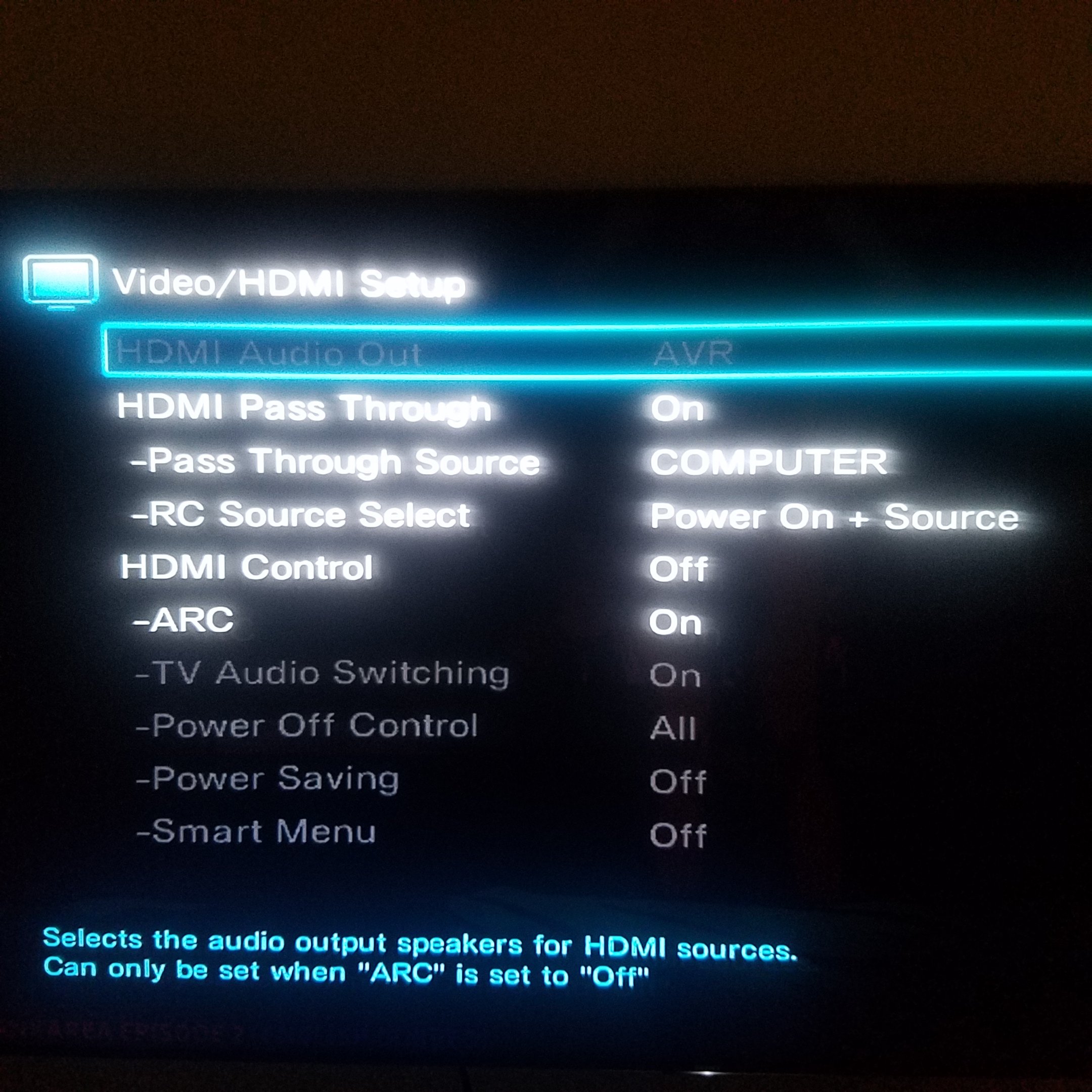

It worked somewhat
Reset TV Reset AVR Do the connection and it worked. Few minutes then the audio is lost
Repeat the Reset TV/AVR it worked again.... Had did it atleast 5 times now...
Point is ARC works. But its not consistent. Maybe Samsung is doing this... not sure.
Thanks again..

Thank you for the feedback. That shows the settings are good because it worked for a few minutes. The fact that it would drop the signal indicated that it could be a HDMI compatibility issue between the TV and AVR.
Are the firmware of both units up to date? There is probably nothing you can do other than making sure your HDMI cable itself is not the issue. At least you can hook up the optical or coax to get the TV Audio.
