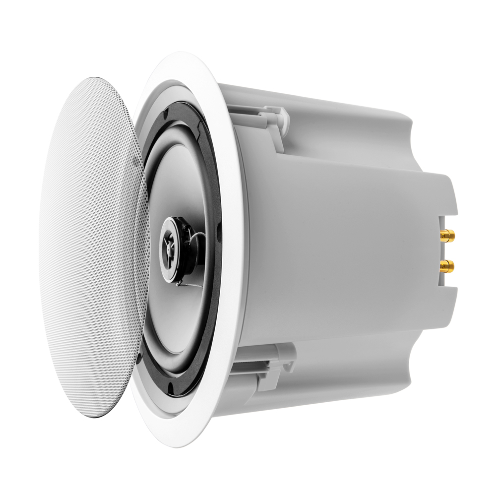

Comparing a speaker like this...
To one like this...
One of the biggest things of note is that the later offers a adjustable 70v voltage selector on the front of the speaker rather than the back. It also is a much higher quality transformer and driver with up to 60 watts of power handling over the 70v line. Is it worth the extra money? IMO, yes. There are similar models from a number of commercial manufacturers. About $100/speaker is typical. On the SUPER cheap side is something like this...
Which is likely perfectly usable in a non-plenum ceiling for low-level background music.

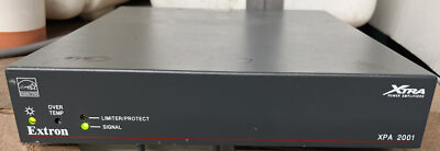

For amplification, you will want something with enough power to drive the 14 speakers. If set to a 15 watt tap, then you need about 250 watts of power from the amplifier to drive them all. With a 10 watt tap, which is plenty for background audio, you can get by with a 200 watt amplifier.
That's a 200 watt 70v amplifier, to your door, for under 50 bucks. And it will last pretty much FOREVER.
If the ceiling isn't a plenum space, you could literally do this, with reasonable results, for about $300 in materials.
