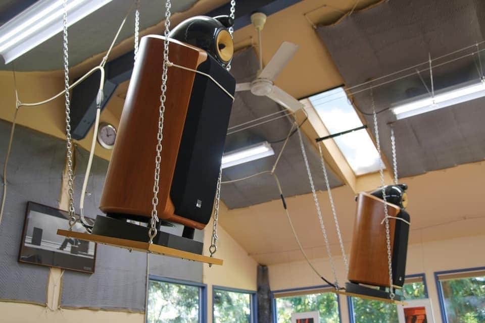

I like the idea of hanging them. Depending on the dimensions of your speakers, there may be some generic macrame potted plant hangers that you could use with minor adjustment!

@KEW I never even thought of that as a possibility. After my initial shock of the idea, that's pretty cool.

I'm glad KEW posted about hanging speakers. I'm planning on doing something similar, but I had figured some folks here would've found that idea offensive, lol.
