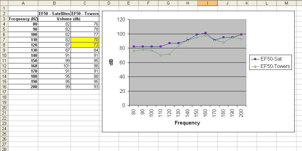

Update, I downloaded some test tones and used a sound meter to measure the output. I am just not sure how to interpret the results...
The tests were run in 2.0 mode with receiver set to -30 db, and speakers set to Large with No subwoofer. The sound meter was placed at the listening position and test tones from 80 HZ to 200 HZ were played. I jogged down the db output on the sound meter for each test tone for the towers, and then replaced the towers, placing the satellite speakers in the exact same position, and repeating the test.
As you can see there is a difference in db output between the towers and the satellites between 80 and 120 HZ. Specifically, the difference is quite large for the 110 and 120 HZ test tone!
Is this normal? Should I be concerned with the output of the towers at 110 and 120 HZ?

Interesting results with the SPL meter. I think that the tower speaker are interacting with your room causign the dip at 120 Hz. Try adjusting the speaker location, distance from wall, and toe in to minimize this effect.
Also, those towers (and setellite speakers) are definately capable of an 80 Hz crossover setting.

Towers are already toed in, but i'll try a different angle tonight. Speaker height was the only other difference in the test since the towers are much higher then the satellites, so I'll also try turning the towers up-side-down :D
