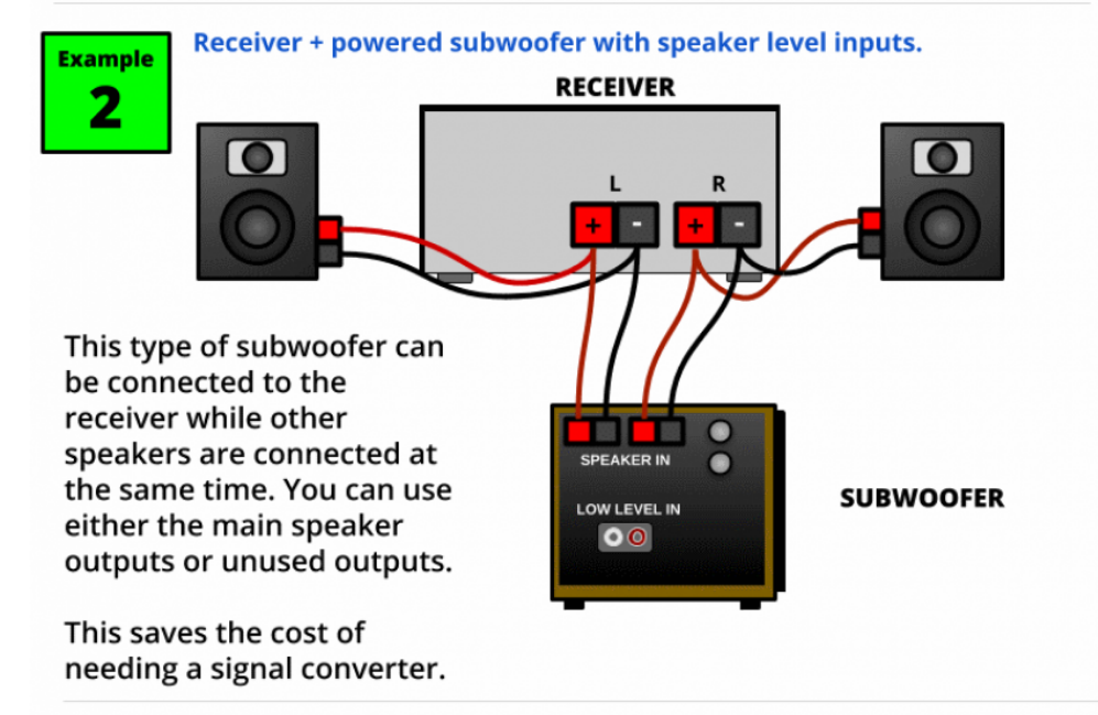

Last question before I go to the dump. I took the left channel out lead and connected it to the sub's left in and it works. Still junk?
Thanks, Frank

What is wrong with this?
I'm not familiar with that subwoofer, but IIRC you will not be able to utilize the LFE channel and that sub doesn't have a built-in cross over. So your Speakers will get a full signal. You will have extremely boomy bass.
Best to save for a decent budget subwoofer like a BIC F12 or a Dayton sub1500. Or maybe check the used market for a used SVS or HSU.
