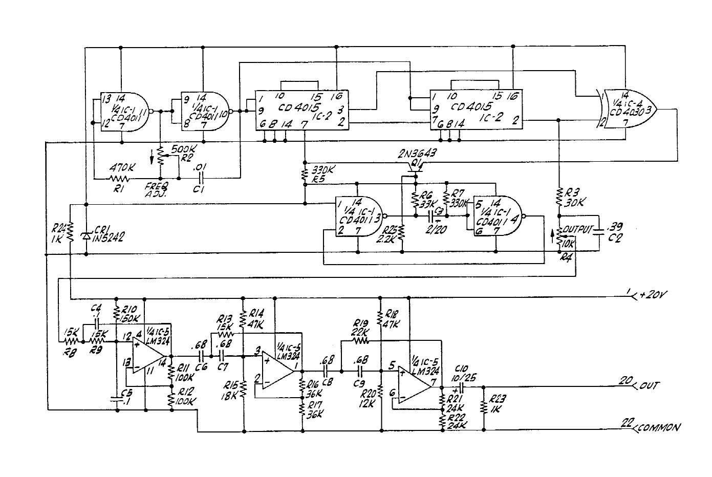

Heres the circuit for the rumble generator, will this need preamping or would I ahve to just connect it?
When you say flare the exit port slightly, by about how much as I don't have a router I will have to sand it.
MDF, plywood costs about £20 more for a single sheet the same size.
That should be able to connect to the amp directly. Just sand a good convex bell on the port at the exit.

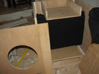

You need to use mineral wool. You will see that the design calls for minimal fill, that means no more than 50% of the internal surface should be covered. The main purpose is to stop reflections. In that case make sure the back wall is covered and the other surfaces just around the driver. So a little less than 50% of the other surfaces will be covered.
If you put in too much fill you will kill the box resonance and the speaker will not work.
lsiberian
lsiberian
Yes, you have it. Just cover 50% like you stated. Make sure you wear cloves and a mask when working with that mineral wool. It is wicked stuff.
Not as bad as fiber thankfully, but make sure you cover it in cloth. I suggest 4" on the back 2" on the other sides.
If your gonna skimp don't skimp on the back
Another option is to put a brace in the box and put the 4" rockwool a few inches behind the driver.
http://forums.audioholics.com/forums/attachment.php?attachmentid=6883&d=1234388792
This is how it's done for the Kappa build. Which is a high quality design. I suggest using that as a model for your build. I plan to use it for the model for my sub
