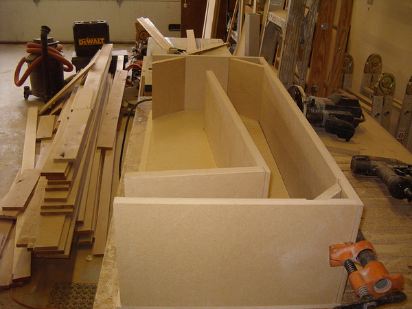

This what the port sort of should look like?

Yes you have the idea of the slot port. I would open the port on the front below the driver so port and driver reinforce each other. Since vent velocity is low, there will be no chuffs or chiffs to hide.
You can run the port along the back and turn 90 degrees up the back, or turn 180 like you show. You still need 45 degree pieces to ease the turns and stop turbulence at the turns. One piece for 90 degrees and two for 180.
This is a TL speaker, not a port, but the design of the turns is the same.
