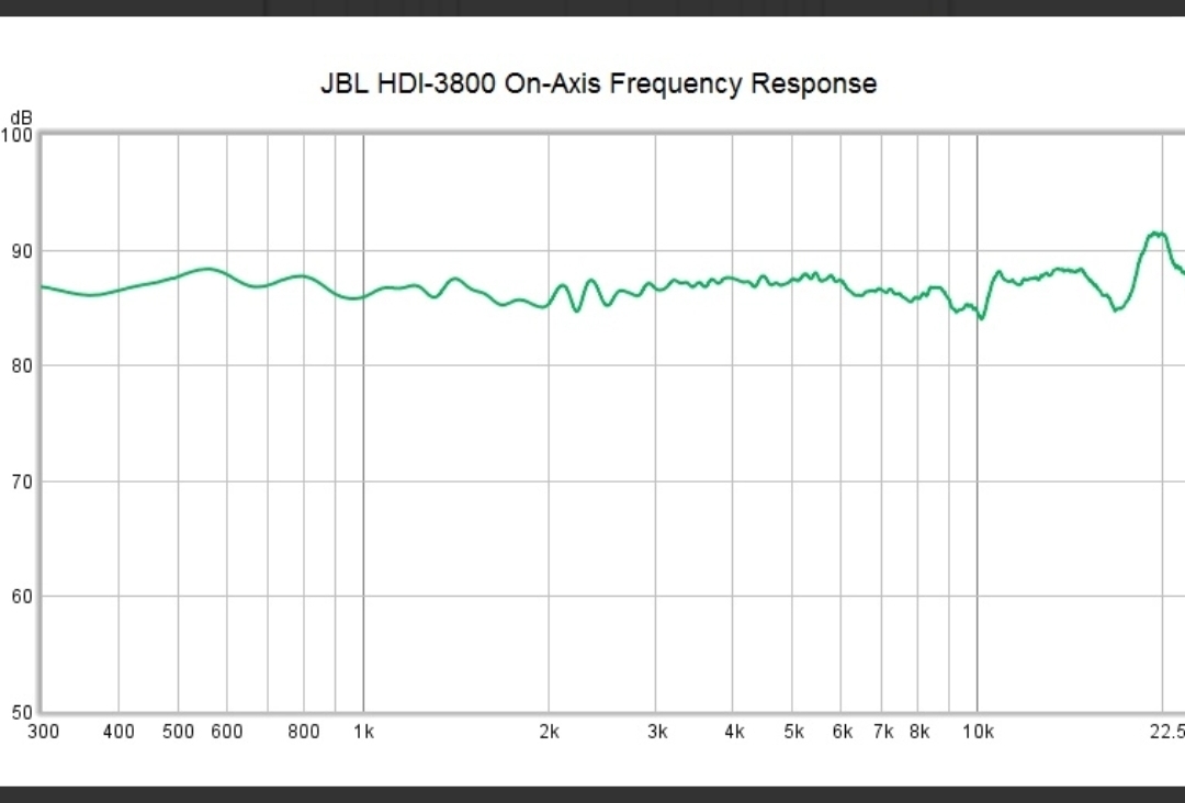

I'd take the JBLs Steven linked before taking the B&Ws. Here is the review of their big brother and should be comparable except in bass extension (there no slouches though).
That's what you want in a speaker. Neutral and the same on and off axis (nearly)
The B&W will not a bad speaker, wont be able to claim that.

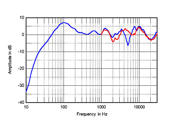

Comparing the larger JBL to the larger B&W you can see the difference between the two responses, the JBL first..
And the 702
The B&Ws are also a much harder speaker to drive with dips below 4ohms
And the 702

Objectively, no the B&W wont. Subjectively maybe. That's why I linked their responses, and the B&W wont have near as good off axis performance (or on axis) . It seems you are hung up on boutique brand names more that what they actually do. B&W (except 800 series) are notorious for their midrange humps and dips into the lower treble. You want a flat responce with good on and off axis performance, that way if you feel you want to tailor the sound to your ear, it makes shaping it easier (I personally want it flat).
The I'd take the Ultras in a heartbeat over the B&Ws. I've owned a few of their speakers over the years and never liked a one. I still have a pair sitting in a closet.
