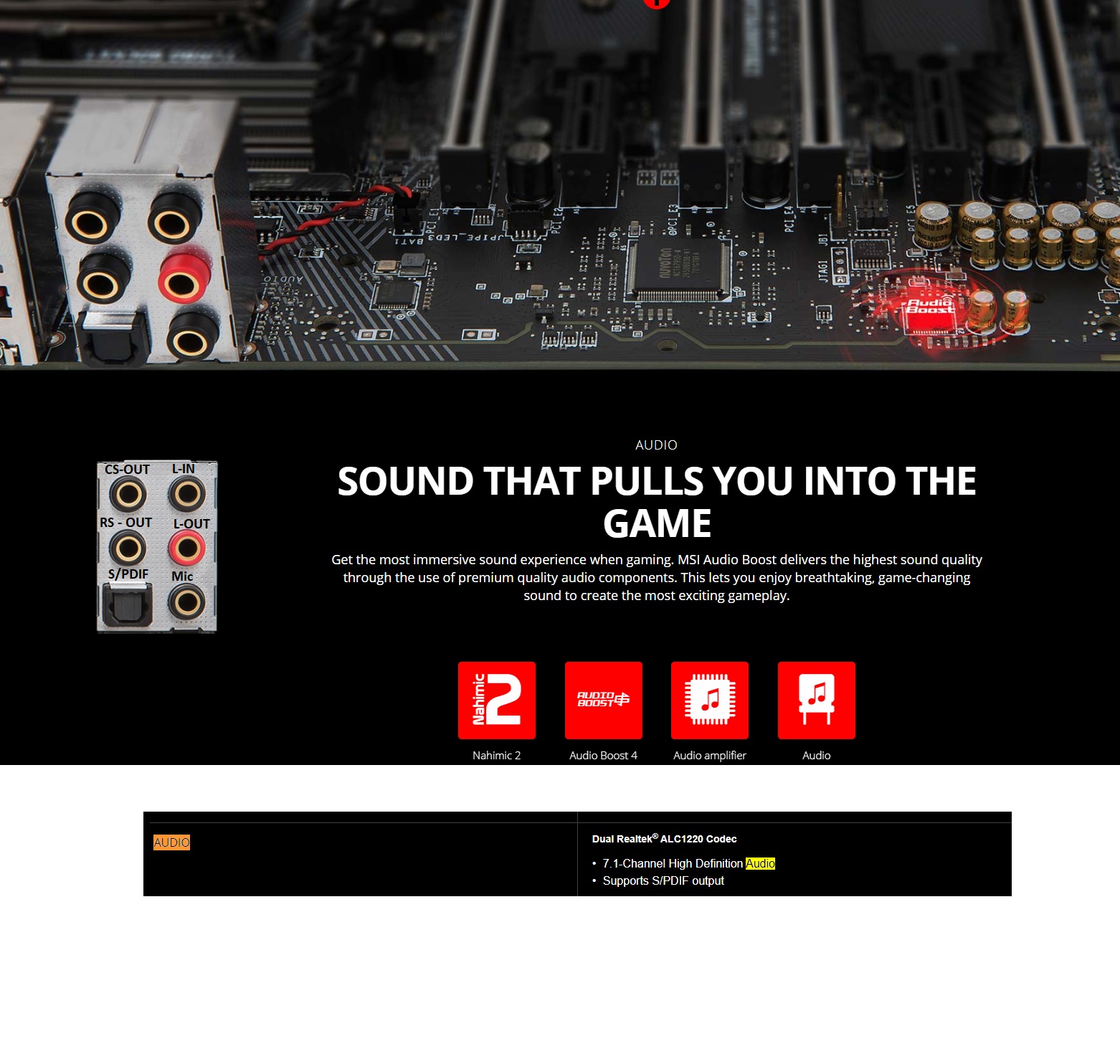

Thanks again, actually I checked my motherboard Audio and as below there is L-in L-Out CS- outr Rs- Out and S/PDIF... Iit seems it support 7.1...not sure if it has sub out or even how should I connect my amp to them as this is my first system ...please see the picture

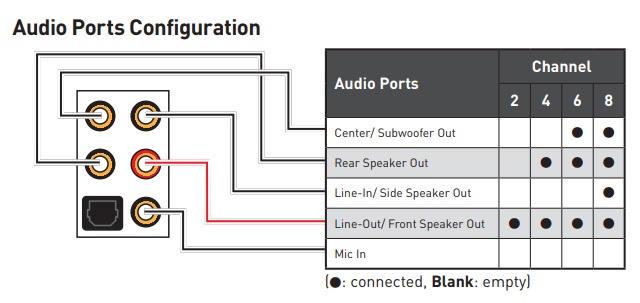

It has a subwoofer output, the jack labeled "CS-OUT" is both the center speaker out and the subwoofer out. Here is the diagram for that audio output configuration:

the table is a bit confusing to follow , the CS- OUT should go to Sub ...but which ones will go to amp ? I have 2 amp SMSL Audio SA-36A and also Lepy LP-2020A and both have RCA Input, my guess is I need to use the Line-out for it?
The "Line-Out/Front Speaker Out" jack should be used to go to the amp for your front left and right speakers.
