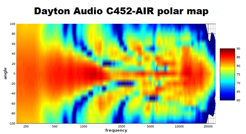

For an MTM center, you are really going to want a low pass filter on the woofers, or else lobing will go very high up in frequency, especially with 4" woofers. See the Dayton B452-Air Center. The damage done to the off-axis response is considerable.
Good point. You're right.
I hadn't thought of the fact that this center speaker lets the two mid-woofers run full range instead of limiting their higher frequencies, as most speakers do. In that case, I think the NHT SuperCenter speaker might be a good solution for the OP. I believe this speaker does have a low pass filter for the mid-woofers.
I am sure the NHT center has a low-pass filter for the woofers! However, a better solution might actually be to just use a bookshelf speaker on its side. It's off-axis response will not be great in that orientation, but it could easily be better than a MTM center.
