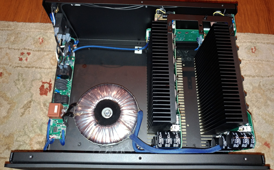

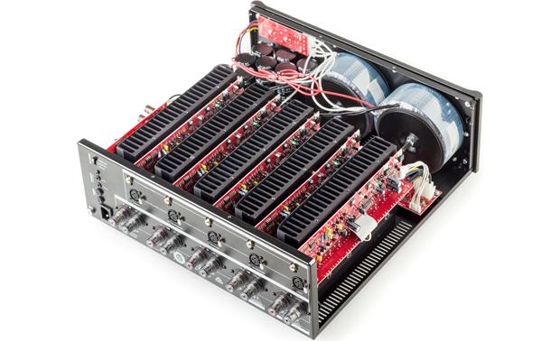

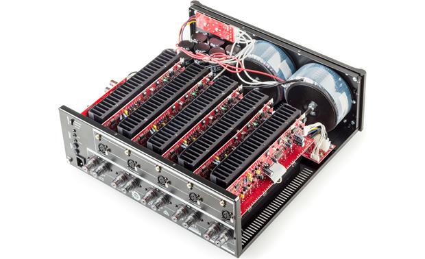

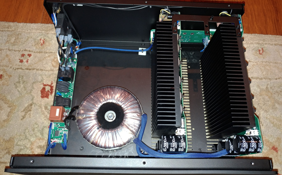

One difference I see is that ATI builds generally have the filter caps on the individual channel boards. The Anthem appears to have a single large bank next to the toroids.
View attachment 25882 vs View attachment 25883
That may explain the difference in channel separation/crosstalk specs. Anthem have the 5 channels share the two transformer so they probably share the 82,000 uF caps too. The Anthem likely have a little better IHF dynamic output even if their transformers are a little smaller.
