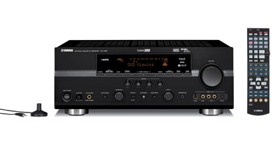

Anybody happy with DD and DTS 5.1 can use a receiver such as the Yamaha RX-V661 connected via optical to a newer 4K TV with external devices connected directly to the
TV's HDMI ports. The pre outs on the receiver can then be connected to an external amp. It also contains multichannel analog inputs for those with players that have them so that lossless audio is decoded at the source. While it does not support lossless bitstreams from Dolby or DTS with its HDMI 1.2 spec, a player outputting multichannel PCM over HDMI would work here.
