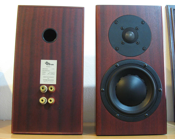

Gentlemen, Please excuse my absence from this thread as work and other obligations prevented me from obtaining a functional meter and taking the readings from the Totems. I did learn from you, TLS Guy, and purchased a $50 Autoranging Multimeter from Lowes which did give me a 'zero' readout when touching the leads. Of course this does not have the rotary selector that previous meter had, so I switched it to 'capacitance' with the Omega symbol and left the 'auto' on as indicated on the screen. Providing that i was correct on those settings here are the readings:
Left Speaker Mid Woofer .44
Tweeter 4.29
Right Speaker Mid Woofer .48
Tweeter 4.46
The tweeter readings are fairly stable, the left at one point dropped to 4.27, but the mid woofer readings seem to vary from .27 to 1.04 whereas my initial readings were as shown above. Is this possible, or have I not set the meter correctly? There is also a button marked 'REL' alongside the mode range and hold buttons.

Thanks for the update. Those readings surprise me. Please give us the make and model number of the meter so we can have a better chance to tell whether you use it correctly.
I don't think it should be on capacitance.
Those readings from the woofers are far too low, and the reading on the high pass circuit should have been infinity.
We need to download that meter manual.

PENG....thank you for your reply. The meter is a Southwire Autoranging multimeter model # 10040N. To be honest I am not at all familiar with this type of device so the chance of my using it incorrectly is great. The fellow that I spoke with in Lowes when I purchased the meter gave me rudimentary instructions on it's use but no information at all on the various settings available on the instrument. If the measurements surprise you there is a strong possibility that I was using the meter incorrectly. Any guidance would be greatly appreciated. Thank you...Joseph

Sorry, TLS Guy. I am no doubt confused as I thought that capacitance was what we were seeking. The manufacturer and model number are listed and when I did a GOOGLE search there was a pdf spec sheet for the meter. Any information on the correct use of the meter to obtain the measurements required for you to evaluate the Totem speakers is greatly appreciated. Again, I thank you. Joseph
The red lead should go in on the right socket and the black in the middle.
The selector should be set to the second setting anticlockwise from the off position. ohm cap etc.
Now you have to use the mode button. Press it until an M followed by the omega (ohm sign) appears in the LCD display
Now put the leads across the woofer connections.
Record the results.

O.K., speakers disconnected and readings are:
Left Mid Woofer 3.6
Tweeter 0.L
Right Mid Woofer 3.6
Tweeter 0.L
These readings are with the meter set as described by TLS Guy rotary dial second setting anticlockwise to ohm / cap and LCD screen mode m (omega).

These readings are what they should be.
So, your speakers are not the cause of your NAD going into protection.
I have no idea why you had to turn the balance of two different amps so heavily in favor of the right speaker.
Now hook up your old Anthem and switch the speakers around and see if the quiet speaker moves with the speaker or not.

It is actually showing infinite resistance, because there is a cap in series with it, which will not pass DC. To test the tweeter you would have to remove it.

Hi folks, again excuse my absence but I have had no opportunity to take the time necessary to troubleshoot and I hope once again that you can excuse my failure to follow through on troubleshooting. I reinstalled the Anthem and reversed the speaker leads and still have to adjust the balance (to the left now for the right speaker) to achieve a balanced stereo level. I played the same disc and track through both my Ultech UDC-100 CD player and the OPPO BDP-103 universal player and found the same balance adjustment necessary. In fact at times the right positioned speaker that requires the use of the balance control will sound a bit like static and drop even lower until it barely plays at all and then will come up again. This happens when I stand between the speakers and adjust full left and right balance to and monitor the sound coming from each of the Totem's. the Anthem does not, however, go into any protection mode and shut down. I have the two players connected to different inputs on the Anthem so that I can A / B the sound switching back and forth. I do not know if this provides any useful information or if this just adds to the conundrum. Thank you again for your patience and assistance. Joseph
So you have proved there is a problem with that right speaker.
This is very unusual.
I think the cap in the low pass filter has failed. The drivers and crossover need removal for trouble shooting.
You will need to return it to Totem or find a competent repair shop.
Where do you live. Since you seem a nice fellow, I would be prepared to sort this for you, if you send me those speakers. If a cap has failed then those crossovers need recapping.
