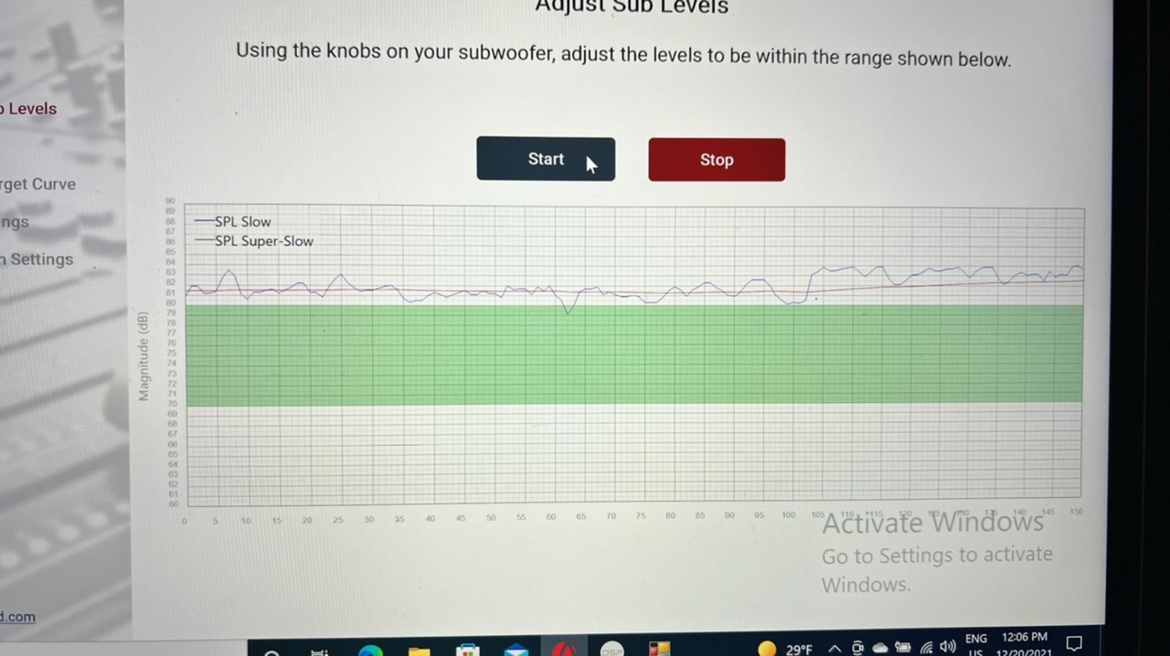

Right off the bat I can tell you that the measurement process does take a bit longer. However it does give you a full FR view of each channel per measurement position.
Pandaman617
Pandaman617
The sub level process is exponentially more precise although the end result remains the same.

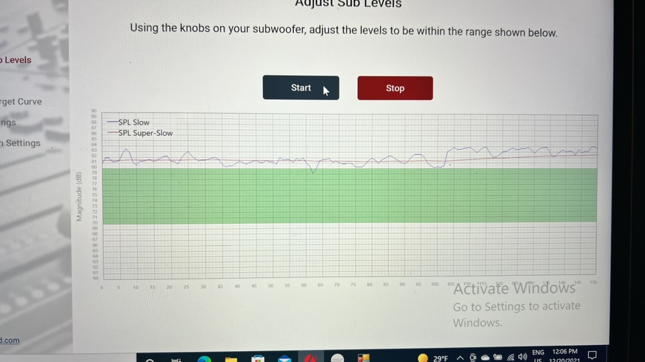

Curious what you mean by end result remains same....how are you determining that?
As in its trying to level match your subs to the level the program wants. It appears to be the same level both in the MultiEQ-X program as well as the Audyssey Multi EQ pro editor app. At least according to my UMIK-1 and REW.
Ah, my bad thought you meant the final eq'd and measured results of the new calibration compared to old....
