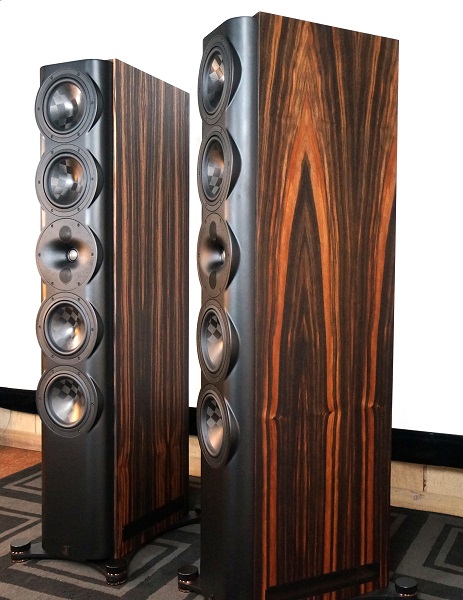

Perlisten Audio is a new high-end loudspeaker manufacturer that has already created a buzz with their THX-certified Dominus speakers. They are currently the only loudspeaker manufacturer to hold this rarified level of certification, but there is a heck of a lot more going on with these speakers than a THX logo. Perlisten Audio was established by a group of industry veterans who decided to make the best speakers that they knew how to make instead of designing products to fit some market segment. They set out to make a loudspeaker that they would want to own above all; a loudspeaker designer's loudspeaker. What they came up with aren't the least expensive speakers on the market, but, on paper at least, they seem to have come up with some very serious high-fidelity speakers that push the envelope of loudspeaker design in a number of ways. In for review today is the pinnacle of their efforts, the S7t tower speakers which are their flagship loudspeaker. Read our full review to find out what these experienced engineers have cooked up when they are freed from the constraints of serving specific market product needs and instead design the coolest loudspeakers that they can conceive.

Dunno what your experience was, yet, but I can tell that veneer must sound as amazing as it looks! ;)
