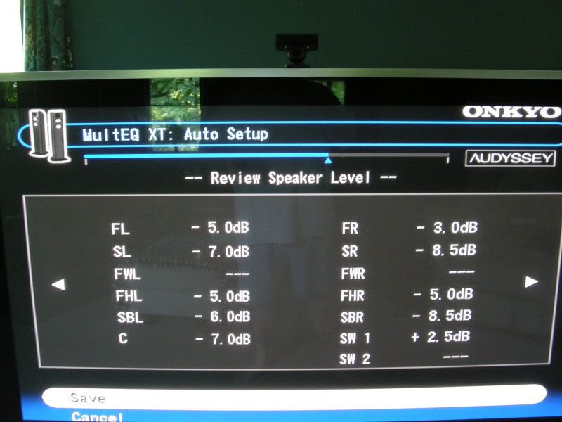

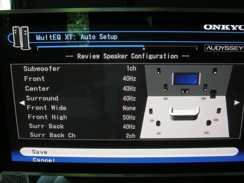

Guess I will continue posting here, here are the settings that were done by Audyssey, SVS suggest using 60 hz on all speakers, should I bumped them up? Guess I'll mess with. New amp is running at the default -20.

Looks pretty good as far as your speaker volume settings.
But I would bump your crossover settings up a bit. I don't like to go any lower than 60hz myself. Between 60-120hz is my preferable range. Obviously set them to what sounds best to you but you may find a mix that's better than 40-50hz.
Try this:
Mains: 60hz
Center: 80hz
Height/Surrounds: 90hz
Remember that the crossover hz is not a brick wall. The hz you choose is where it STARTS to roll off. If you have a speaker crossed at 40hz you still get frequencies as low as 20hz reaching them. Yes it will be a lot quiter than the 40hz tone, but if you listen at high volumes you can risk overdriving a small speaker (6.5" or smaller). I believe most receivers have a 24dB per octave roll off.
If your heights /surrounds have smaller drivers like 5.25" then typically an 80-90hz crossover works well. This will lower your distortion, allow high master volumes, protect the drivers & let your sub handle the mid-bass better. I personally use the crossover settings I listed above & all the drivers in my system are 6.5" (except for the tweeters & subs of course!) Every system is different but 40hz seems a bit low for those JBLs.
