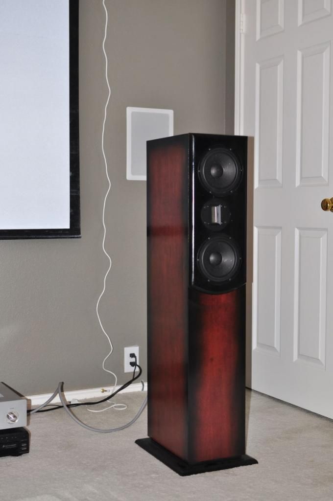

So finally i got around to playing with it. I moved them from the living room with hard floors and open ceiling to my study which is carpeted and much smaller (11x12). The difference was night and day! Suddenly the highs and mids that were recessed were more prominent and the bass that was overly powerful seemed to be a bit more under control.
I think the bass was overwhelming everything else downstairs and that gave me the impression that mids/highs were recessed. Goes to show that room is probably your most important part of the audio chain. Get that right and you'll be able to fully enjoy your system.
I'm listening to natalie merchant as i'm typing this, and can only marvel at how she sounds through these speakers. This speaker has a top to bottom coherence that i've not heard before. I love my selah SSRs, but they are small bookshelf that have little bass. This has a honest mid 30s response, and is an extremely smooth sounding speaker. Imaging is pinpoint, and sound is very well layered.I'm driving them with a hybrid integrated amplifier - Yaqin VK-2100.
Highly recommended speaker. Thanks to Paul K and Dennis for creating this wonderful speaker.

That's awesome and I totally get what you're saying. These might be the most finicky speakers I've ever owned as far as room treatments are concerned! It's amazing how much placement changes the sound of these.
If you like Natalie Merchant, try Mazzy Star's Blue Light on them. Just relax in your chair and wait for the guitar in the middle :cool:!
Nice job on your cabinets btw; they look incredible!

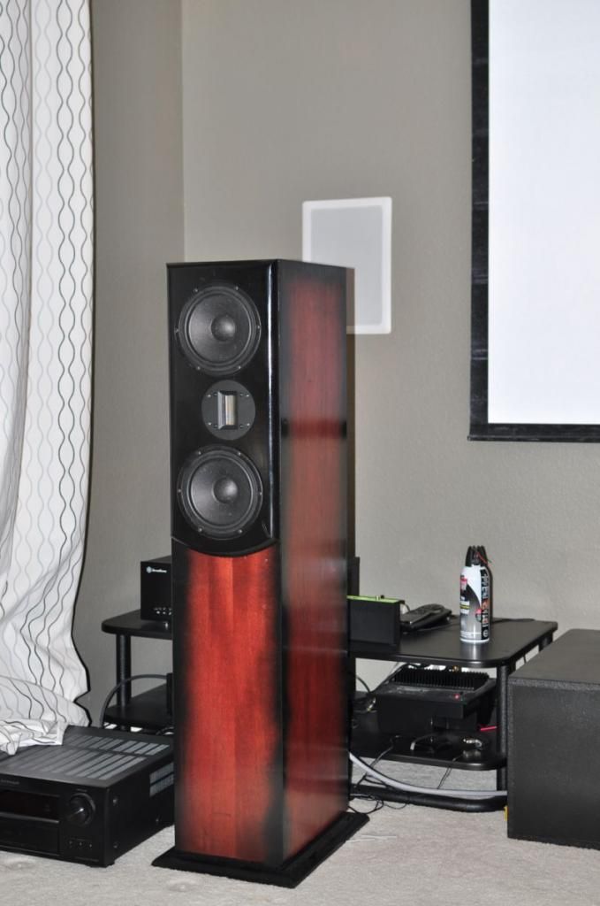

doors666
Audioholic Intern
capricious, in post 14, arent the left and right speakers switched. I thought the tweeters are supposed to be on the outer sides. How is it for the rs28 domes?
Quick question, the base is larger than the speaker by about 3.5" in depth, how is it divided, equal for front and back, 1.75"?
C
capricious
From what i read someplace long back, u want the tweeters on the inside if the room is small, and on the outside if it is placed in a larger room.
As for the base, i centered the speaker on it.

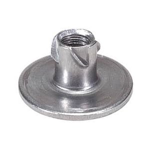

Just for the sake of education for DIY newbies, the kind of threaded inserts I have not had success with are shown below. Some one else may have a good method for using them, but not me.
T-nut (Don't be tempted to hammer it in, it will not go in straight)
Hurricane nut
mattsk8
mattsk8
I've never used the Tnuts before. I would certainly say they're a bad choice for MDF, I'd imagine you'd just fold over the little spikes and make a mess of the MDF. I could see how they might work in baltic birch or some softer wood though. But, given the other options I might choose differently anyhow. Thinking of baltic birch made me realize that I've never tried to use threaded inserts in ply before, only MDF. One area I could see an issue w/ that would be the potential to delaminate layers of ply while threading them in. For ply, I'd probably go the hurricane nut route and use a C-clamp to install them.
The T-nuts as well as those ones you have to pound little brad nails into; not a fan!

Well, i rewired my crossover and replaced the monster cable wire with another garden variety cable (acoustic research from amazon). Also i painted the baffle black. Thought it looked much better this way.
I am not sure if i'm imagining this ... but the speakers are sounding much much better. I always thought that the highs were kinda muted but with the wire change, they sound extended like what i expected a ribbon tweeter to do. Listening to "Fujiyama" CD i can attest that bass is as strong as ever. The vocals sound wonderful.
Overall, i think this is the best floorstander i've heard. :D
Swerd
Swerd
I really like the way they turned out. Excellent work. Thanks for the pictures.
